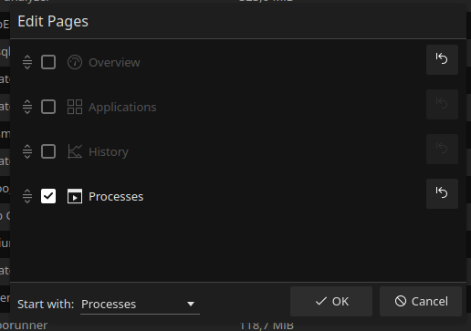

plasma-systemmonitor seems to be working fine
If by fine you mean loading for 3 seconds, instead of 0.3…and between switching tabs instead of seeing content of it see a freaking :gear: rotating for quite a while, sometimes in a dead loop that you will need to restart it…than yeah, it’s perfect :roll_eyes:

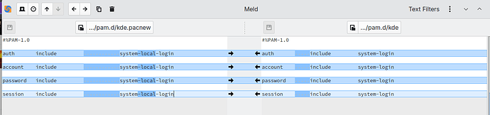

Did anyone get this?
Edit: Did the changes and the login window is back now :slight_smile: All good.
I’ve setup like that and collapsed the sidebar. No waiting, no rotating thingy :stuck_out_tongue: and its fast enough?!
