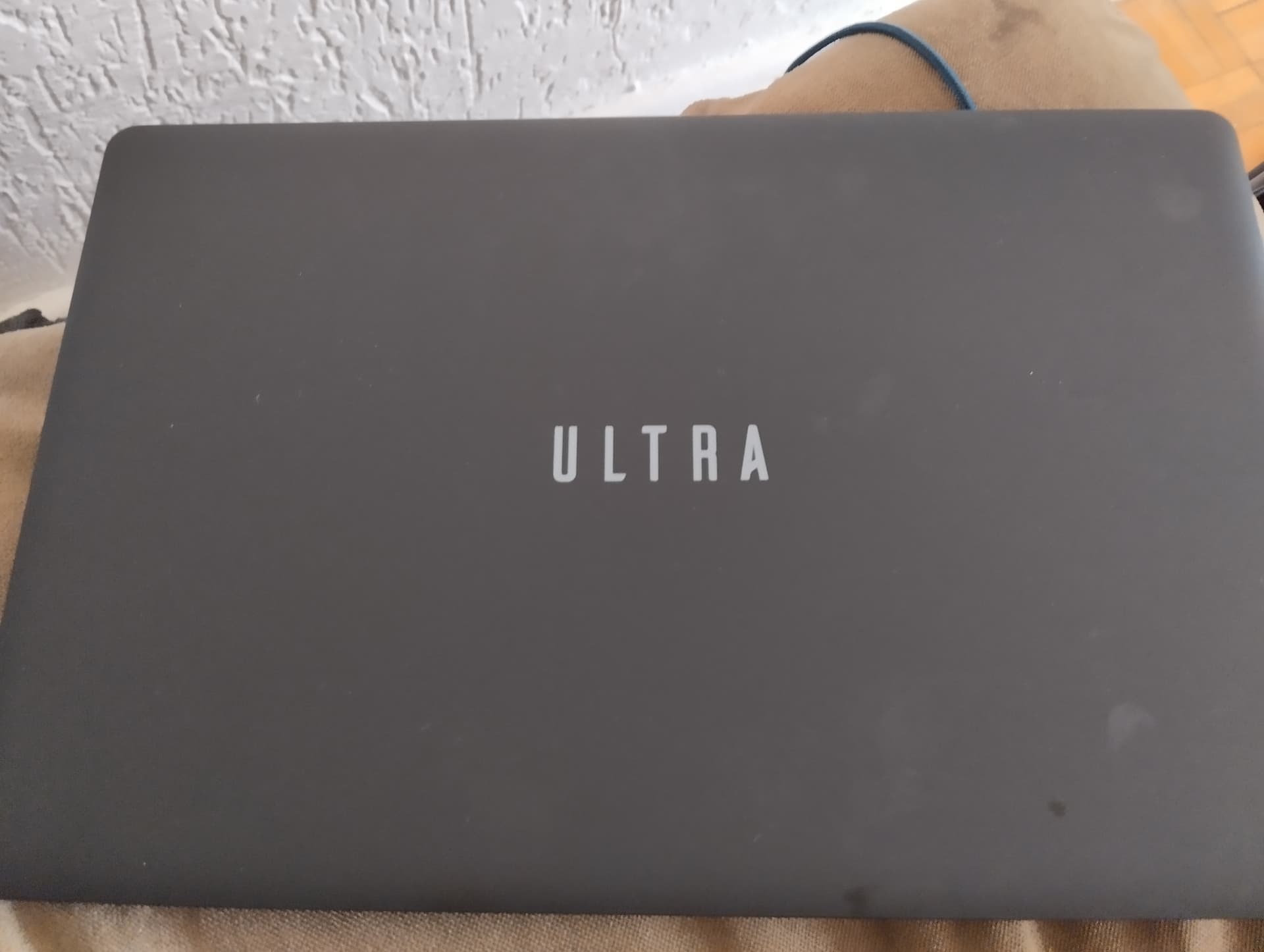

That’s the notebook brand, it came with windows 11 and has a intel celeron so I wanted to run a lightweight linux on it to get the most of it.

Thanks for sharing. First time i’ve heard of the Multi laptop brand.
(assume your from Brazil)
https://quenotebookcomprar.com.br/multilaser-ultra-ub235/
Interesting the inxi command did not show your wireless card.

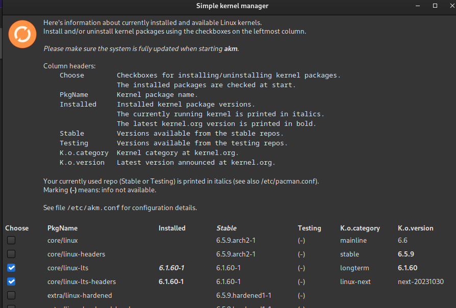

I’d like you to use the ‘akm’ tool to install:
  • linux-lts
  • linux-lts-header
Reboot your computer. When you boot your computer you should see an option to use the LTS Kernel. Lets see if this improve things.
I did the install and now I don’t have wifi
Thats a good sign. That means your wifi driver is not in the LTS kernel (which usually means an extra driver has to be install for LTS).

All these tests I’m doing them in the unstable kernel not the LTS.

So if you use the LTS Kernel, then you will need to install a driver like this one from the Arch AUR:
https://aur.archlinux.org/packages/rtl8723du-dkms-git
@dalto I need some wisdom from you. Based on this long post we have figured out that Hectors laptop:
  1. Is using a Realtek rtl8723du wifi\bluetooth combie card which is connected to the USB interface.
  2. The LTS Kernel does not have a driver to support this bluetooth\wifi card.
  3. The 6.5.9-arch2-1 kernel does support the wifi card (But connectivity is unstable and just drops connections randomly).
It seems the best solution here is to install the rtl8723du-dkms-git driver package from the AUR and try this with the LTS Kernel:
  1. Install yay as the AUR helper:
sudo pacman -S yay
  1. Install the rtl8723du-dkms-git driver
yay -S rtl8723du-dkms-git
  1. Reboot laptop and use LTS Kernel and test wifi with the new driver.
Is there another solution we should consider? Thanks
