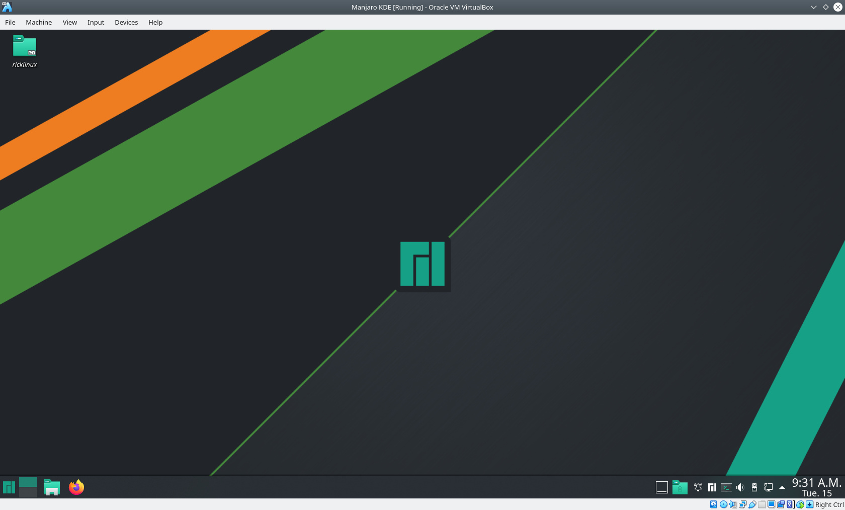

@Alexander
I did an install of KDE Plasma also just to show you and there were no errors or any issues installing in Virtualbox and is full screen. The resolution currently on this machine is 1680x1050 When installing in virtualbox i always start the installer and when it starts the install i maximize the box. Then as the install starts i click on the view tab in virtual box and wait until the view virtual screen becomes available and i set the resolution. Then it automatically changes at a certain stage. It just works for me and i find this easier than some other ways such as the display settings or using xrandr. This works 99.9% of the time on most distros if you are using VBoxSVGA and setting it as i explained in my earlier post.
Screenshot_20200915_093139
Edit: I do not do anything with inserting guest additions cd image if that’s where you say you are getting errors.

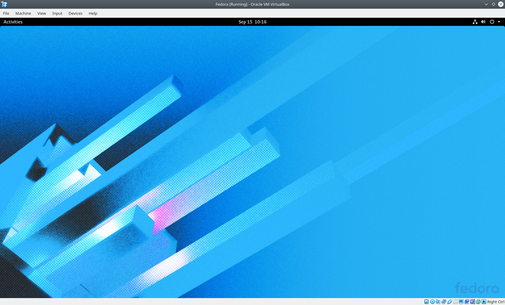

@Alexander
Here is Fedora for you full screen.
Screenshot_20200915_101632
I don’t understand what I’m doing wrong. I’ll keep trying and doing it it your way as closely as possible.
