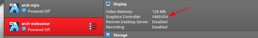

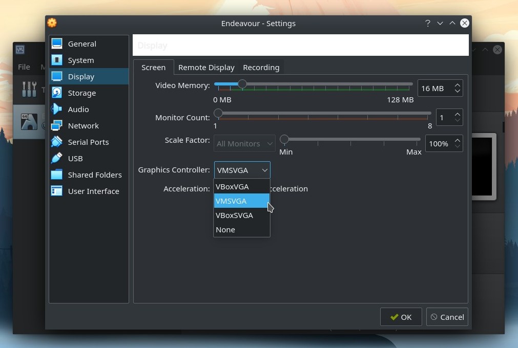

I’ve had the same issue and will occasionally need to change the Graphics Controller in Virtualbox in order to get the full 1920x1080 resolution.
Can you explain further?
The default graphics controller for the guest system you’re installing through Virtualbox is VMSVGA. There’s a drop down menu with a couple other choices. Sometimes one works better than the others, so it’s worth experimenting.
Screenshot_20200915_174529
Hope that helps!
