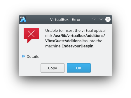

Maybe that is what he is talking about? I see here on mine this is what shows but i have no problem running virtual box now since the update.
Edit: This has no effect on my ability to use virtualbox.
Screenshot_20200912_091121
Screenshot_20200912_091136
that is exactly the error I get. I cant go fullscreen because of this.

Didn’t read the whole thread, sorry if I say something that was already said.
But the package virtualbox-guest-iso, if needed at all, should be installed in the host system. Then host can provide virtualbox guest additions to a VM, e.g. Windows, or perhaps some non-arch distro. If the VM distro is Arch based, then you don’t need to install package virtualbox-guest-iso anywhere.
Thanks @manuel i thought maybe that what he was referring to and honestly i never really bother much with the guest ISO. Didn’t know that. I just use it. :laughing:
