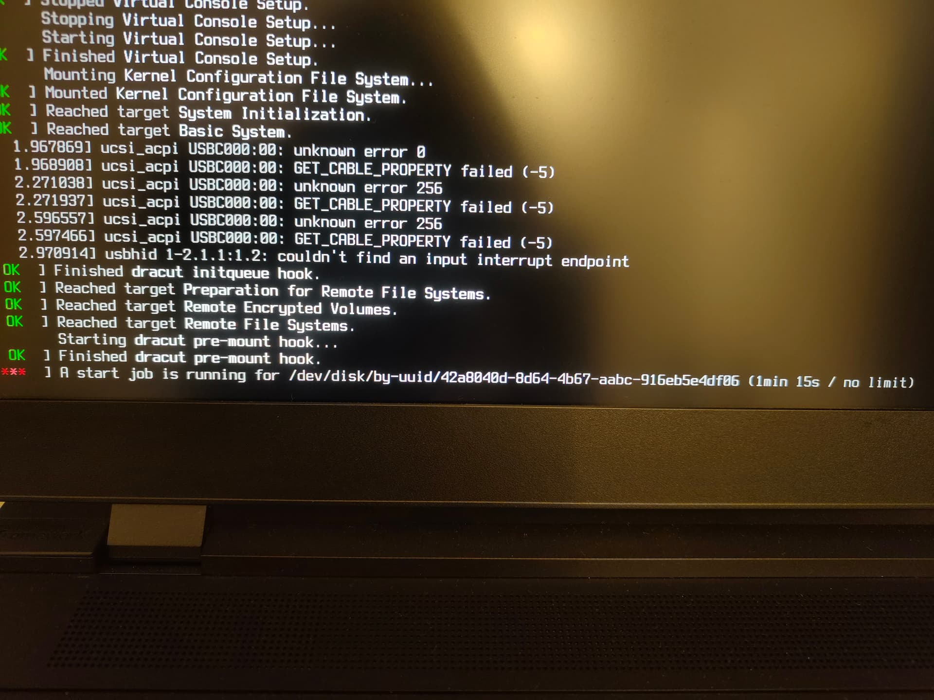

Using linux-cachyos-lts and linux-lts didn’t help as it began a start job and went on and on for 7 mins (after which I forced switch off):
