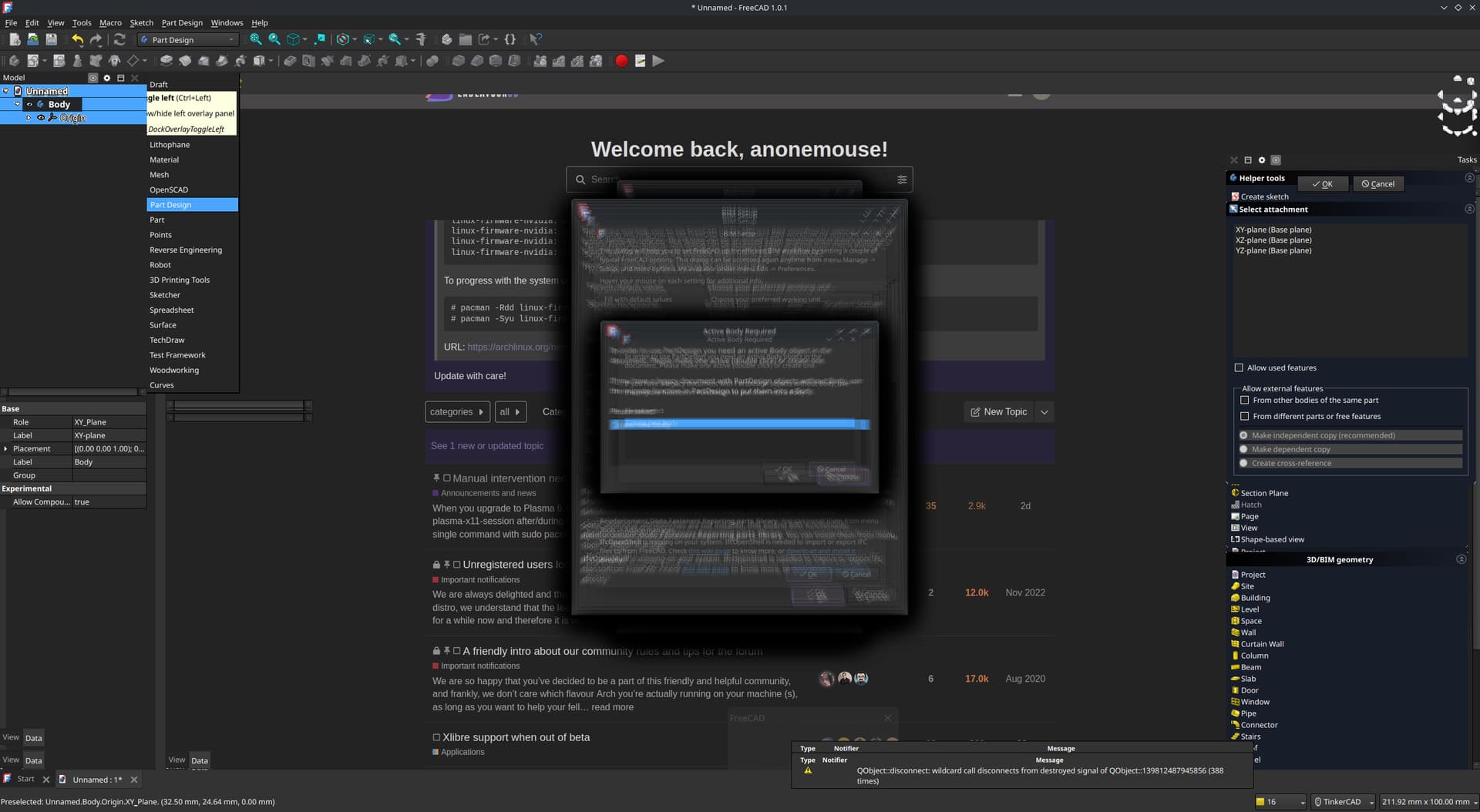

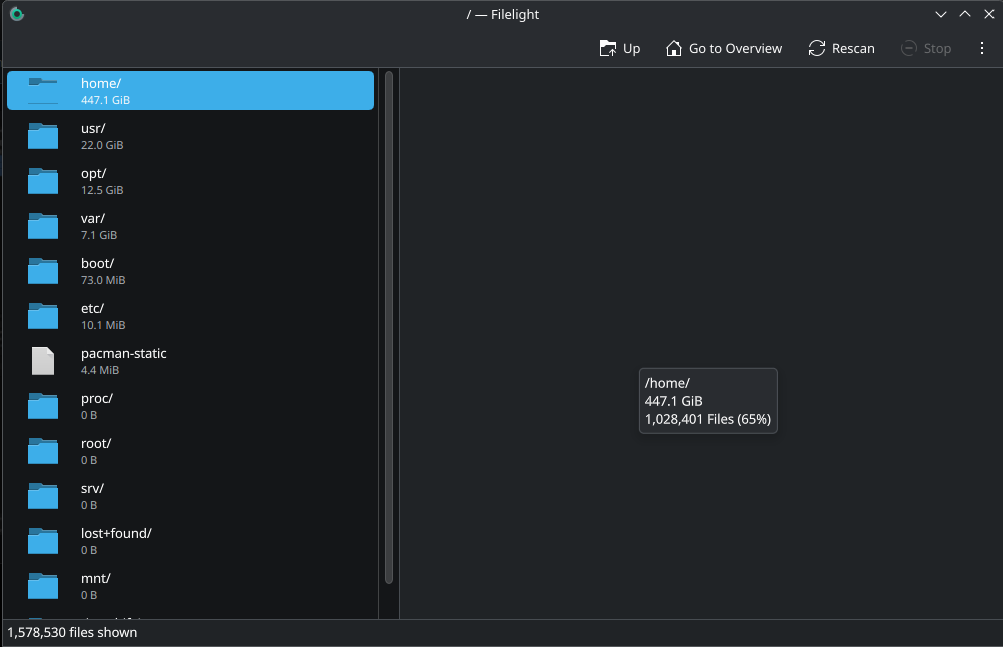

Since the last Linux-firmware update, There are some apps that aren’t working well, like FreeCAD (Main work environment not visible), Filelight (pie chart not visible), those are the ones that I’ve noticed for now. (see screenshots).
Wondering if that’s a Wayland issue or something else?
Any ideas? I need to use FreeCAD.
(This Post seems interesting, but I have an Nvidia…) Would Downgrading be the way to do it for now? How do I do that?
