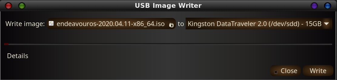

I decided to try this thing (popsicle) out - and ran into the same âproblemâ - I couldnât find it! Keeping an eye on things here, I saw it was the name that lost me. So - I tried again (as a command line utility it is pretty pointless - I already have dd). So - it looks sort of OK, in a gnomish way - but I donât see any advantage over mintstick. One thing it DID do, though. It gave me qa really pretty lightshow on my conky, as it hammered all 8 cores for quite a while in the process of installing! It even caused the CPU temp to exceed 70C, which added to the lightshow (graph goes red at 70C, current settings). I canât really imagine whatâs there that needs so much work to install thoughâŚ
And I wonder why I end up with a bloat count of packages! Back to mint-stick, as it looks fine
