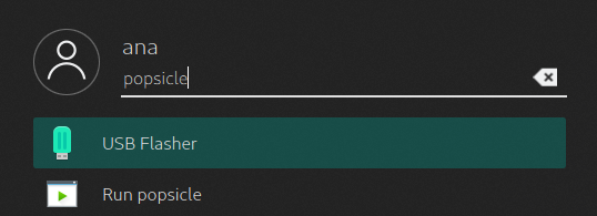

I installed it as well (just to see what the fuss is about :slight_smile: ) and don’t seem to have a related .desktop file as well. It appeares in my app launcher though, under the name USB Flasher (on Plasma).
popsicle
Oh! I bet that is the issue. It is in the menu as “USB Flasher” so if you are looking for popsicle you might not see it.
It should be in /usr/share/applications/com.system76.Popsicle.desktop
HA! That’s it! I’m using the Xfce DE and it appears under Applications/System/USB Flasher.
