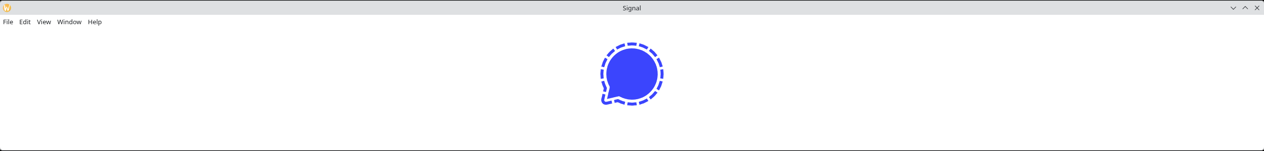

Hello together,
I try to set up Signal-Desktop on a freshly installed EOS.
Unfortunately, the app is loading, but all the buttons are missing, so I cannot link my device or do anything else. Also the window settings are completely unresponsive.
Does anybody here have a similar problem?
I am using KDE-Plasma.
Thank you very much for your help! :smiley:

That is interesting. On my work laptop it is also working fine, but not on my (much older) home laptop. :thinking: It has been working until I logged out, then I installed my system again and now the error is the same as before new installation.
Anything if you run something like
journalctl | grep 'signal-desktop'
in cli?
Thank you for your support! Does this help?

Update: Starting Signal-Desktop with…
signal-desktop --disable-gpu
… workes so far. But if I close it and start it the usual way, it does not work anymore (again).
Nevertheless, also starting without gpu throws an error:

I think this should not appear in your Log. Something QT-related may be missing. I’m not near my PC at the moment, so can’t look into it just now.
The binary /usr/bin/xdg-mime comes from the package xdg-utils.
warning: xdg-utils-1.2.1-1 is up to date – reinstalling
xdg-utils was successfully installed already, but this issue appears nevertheless. :confused:

I also did some more research. On Gitlab the user Robin D’Haese wrote:
So one solution might be to create this symlink as mentioned:
sudo ln -s /usr/bin/qtpaths6 /usr/local/bin/qtpaths
However, I guess after the next update this workaround will be useless.
