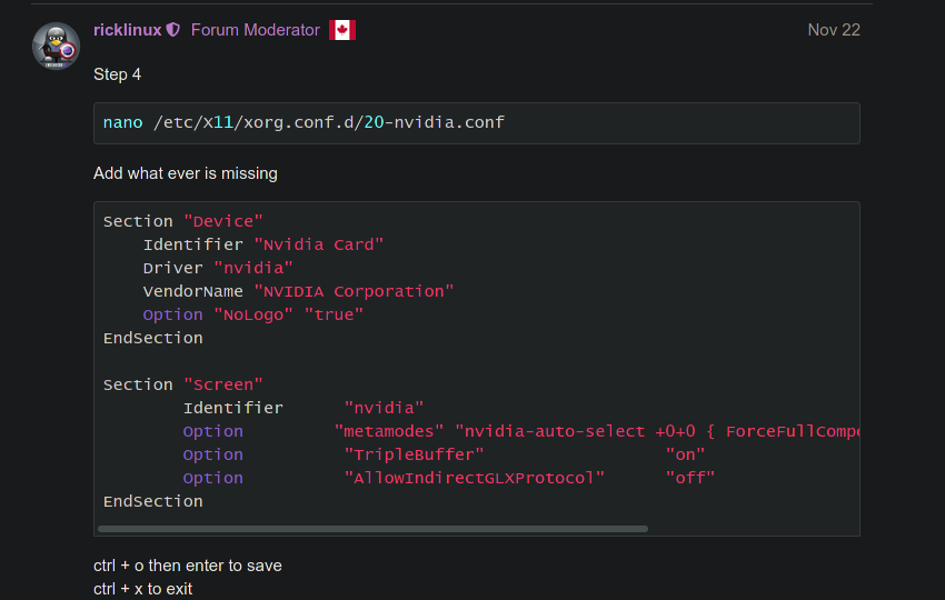

I didn’t quite follow this step from @ricklinux
so no 20-nvidia.conf file used?
It didn’t generate automatically at first so I created a new file with the details above. No luck still.
it should not need such config per default… they are only to set options you may need like composition pipeline … dpi settings e.t.c.
