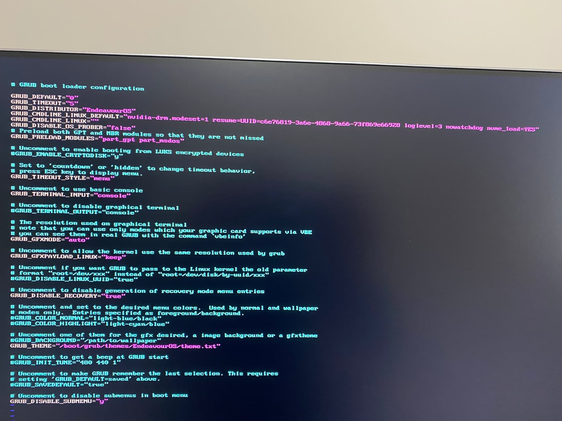

okay, sure. installing it in background.. I also checked the grub file and it doesn’t have the nvidia line. should I add before reboot?
it currently shows
Yes i would add it and update grub with the update grub command.

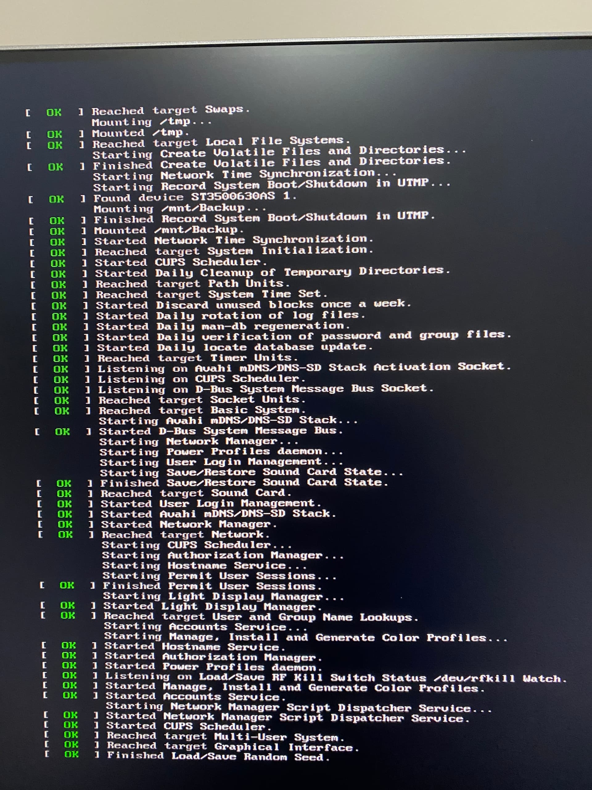

Okay so stuck at the boot screen
Reached target Graphical Interface
Is this what has been happening all along since you have done a reinstall?
Correct.

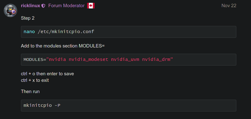

Can you go into a tty and edit /etc/mkinitcpio.conf and then run the mkinitcpio-P command and reboot.

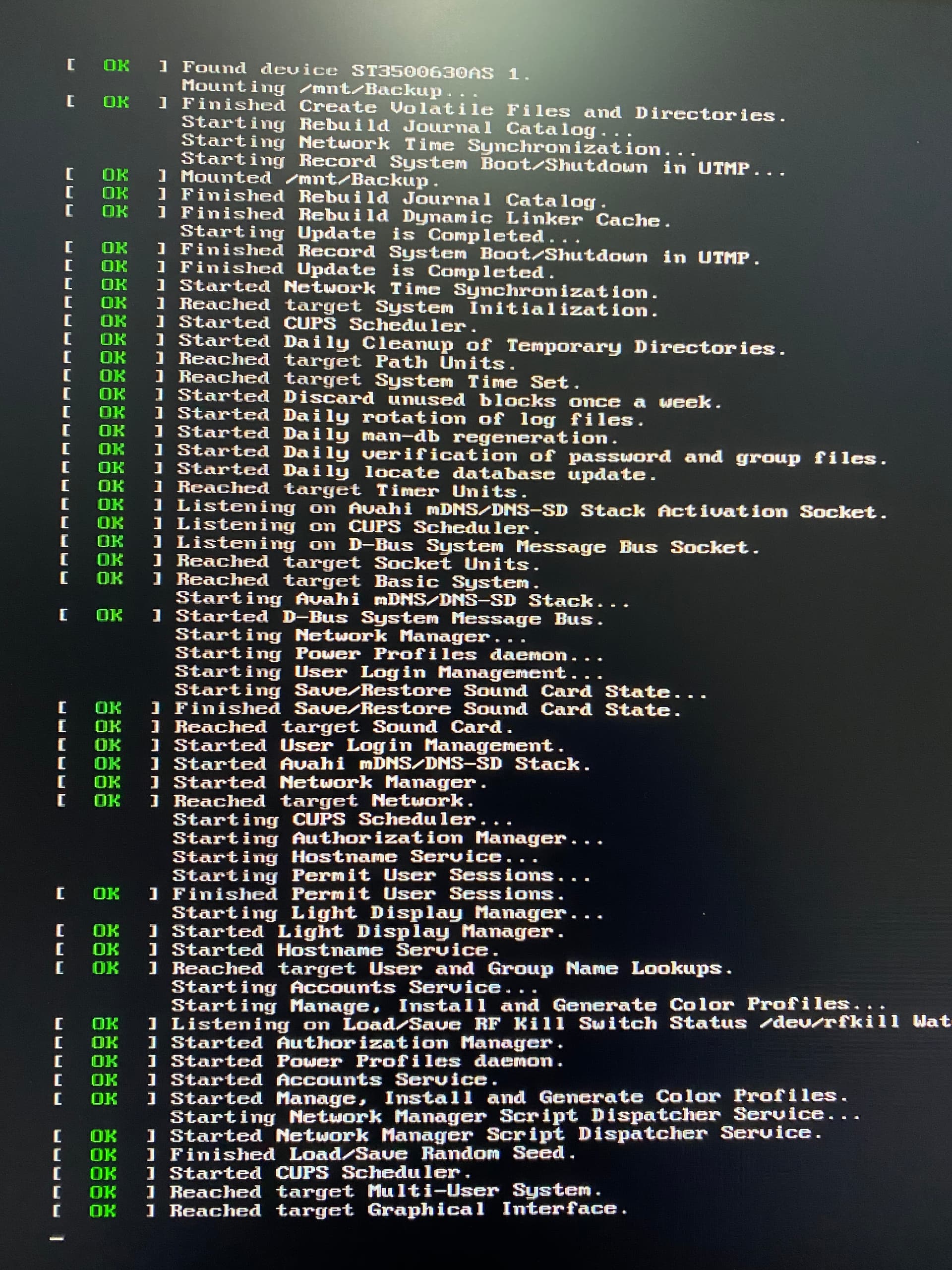

Running into following codes when I ran the command mkinitcpio-p
Did you try reboot?
Yes and now there one additional line “Finished Load/Save Random Seed”
I remember having those same error messages. So try removing everything from the mkinicpio.conf and then run mkinitcpio -P and see if it rebuilds the kernel modules without those errors.
So after removing everything in the file, the kernel module built successfully and rebooted the PC but not passing through the Graphical Interface Line. :frowning:
This is the current GRUB file
