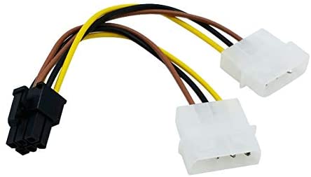

They are cheap so it is best way to test if this solves your problem as @Echoa said.

The exact power draw is going to depend on the version of the 5700 you have, 160w isnt the peak but the average you will peak higher. Also the issue is the stability of the power the cable can deliver, daisy chain cables deliver less stable power vs individual cables.
I.E the 5700xt (yours being 5700 i know) is rate for around 180w but because AMD measures power draw at the VRMs and its less accurate you may be +/- a significant amount but its a good enough ballpark. My Sapphire Pulse 5700xt draws over 200w during load.
If you have a board partner card with a better cooler its likely been set to run higher/faster and peaks will likely exceed 200w. Due to power losses with the cable and depending on the PSU design you may be experiencing issues related to the PSU/Daisy Chain cable especially if the cables are made of aluminum which lower priced PSU tend to use (not sure of the tier yours is)
