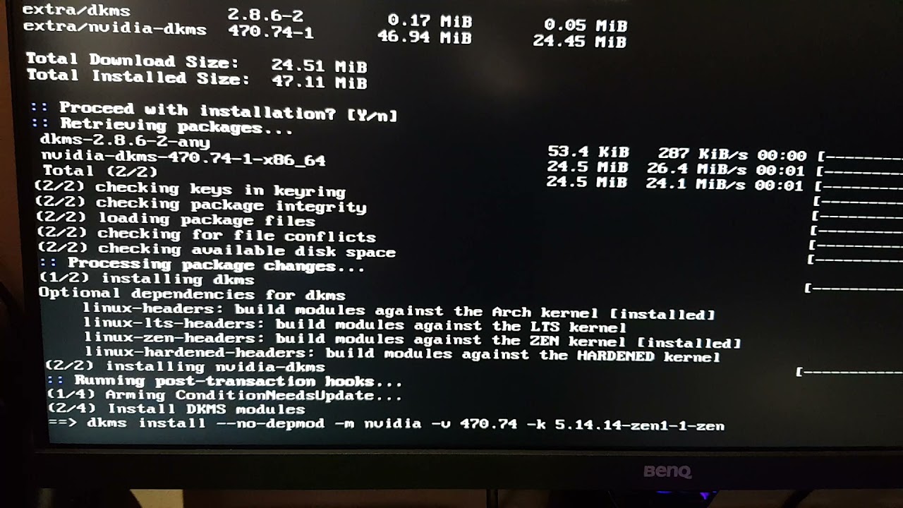

this guy has VERY similar problem, but I didn’t use any special kernel
so you are out, or you want to get knowledge about how to get Nvidia running on your system ?
This Guy is Eric Duboix from Arcolinux showing how to install nvidia-dkms driver if you are running zen kernel… Not the same issue if you are on a optimus system.

sorry, flustered, installed says compatible, installs fine, same exact issue as the youtube dude
