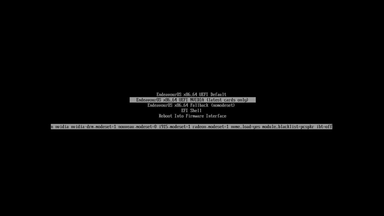

If you have the issue to not be able to boot you can work around by adding this kernel parameter when booting ISO with the Nvidia boot option:
On boot menu go down to Nvidia Boot entry and press e to edit boot parameter line:
Press end to reach the end of the line:
Hit space to spertate the added parameter from the one is there already and enter ibt=off parameter to be able to boot:
Hit enter and boot the ISO with this added parameter.
