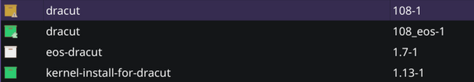

But it did not help. Nothing changed at all. It should also be noted that I did not install / remove anything related to dracut / grub.

Find dracut in Octopi (eos-dracut not installed):
