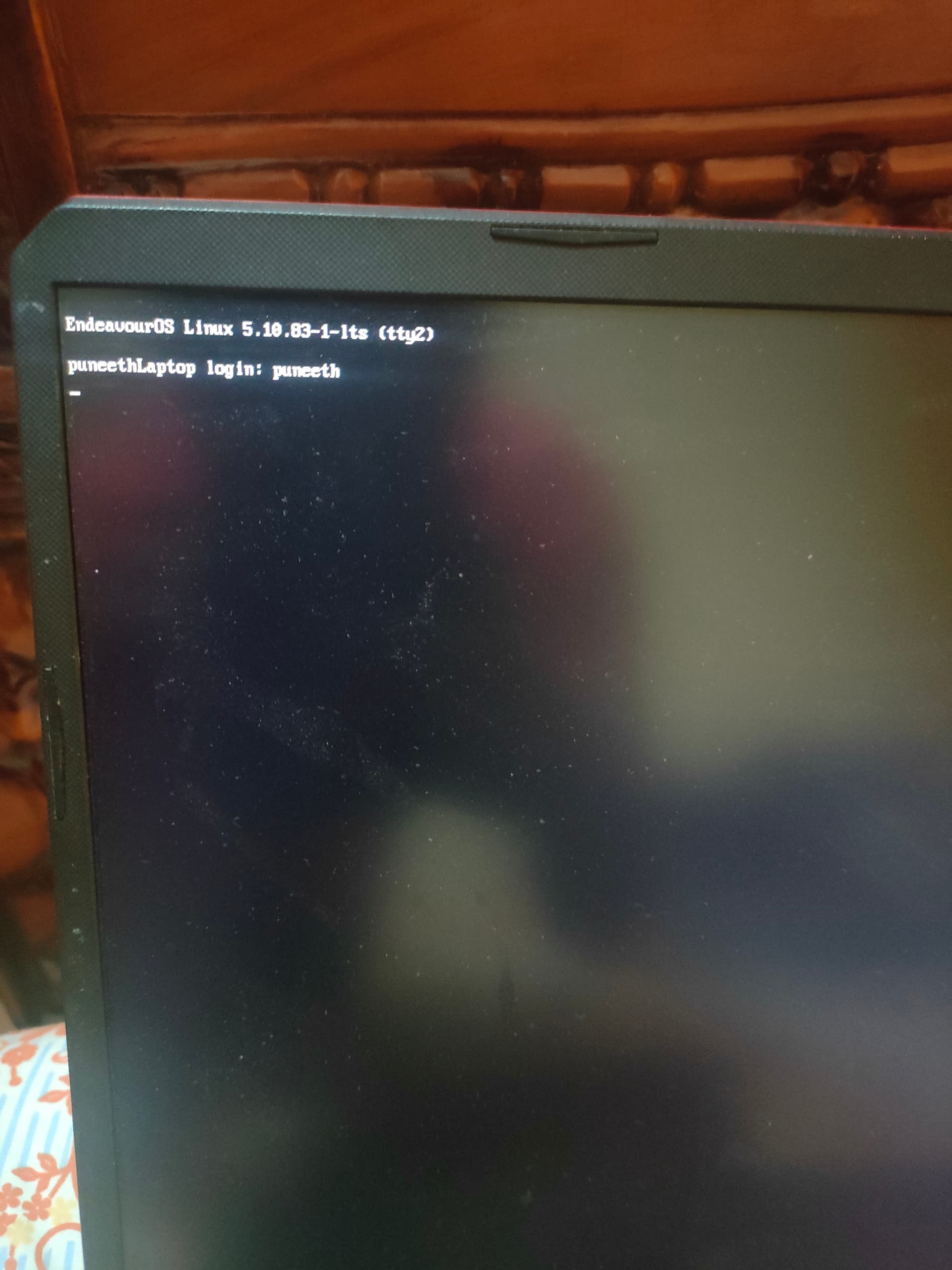

Are you able to get to a tty? ctrl alt f2 Log in as root.
Nope
Got stuck like this
