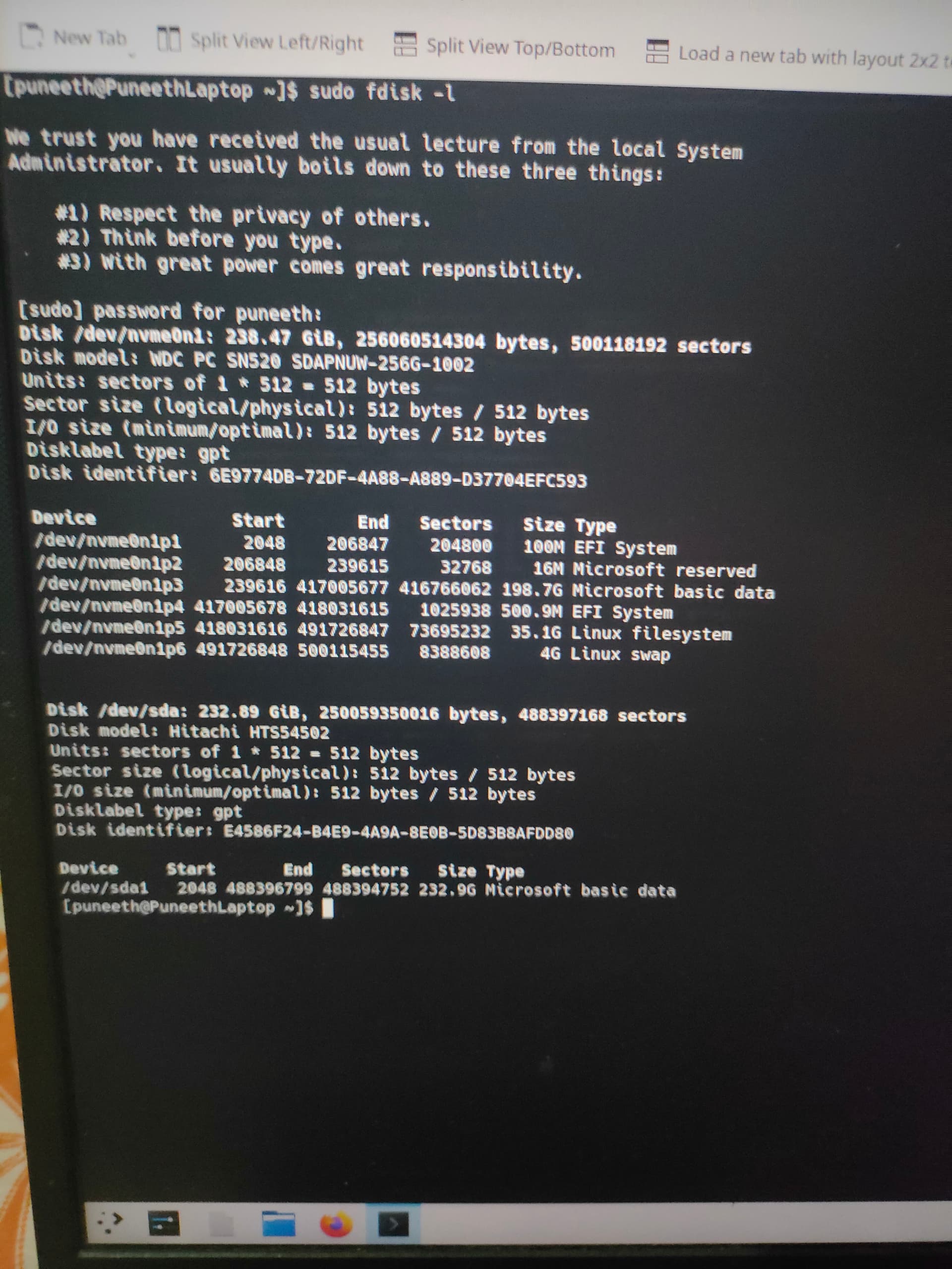

Can you open the terminal full screen and try again the command.
sudo fdisk -l
Copy and paste everything in the Window here with code tags from that command.

I’m trying to understand how the nvme drive is partitioned and what is installed on it? The ssd looks like it’s microsoft data. It’s not very clear to me. Can you explain it?

Ok i just booted normally ,typed as fast as i could and it worked

Okay well it looks as though you installed EOS on /dev/nvmeon1p5 adn your swap partition is /dev/nvme0n1p6
Your efi partition is on windows /dev/nvme0n1p1
So all that look okay. The ssd /dev/sda1 i assume is just microsoft files
Yeah
I do have my eos on the same ssd
You said you tried to install drivers from manjaro. I think it would best to use Windows and create a new live usb with etcher and then reinstall EOS. There should not have been any issue with the install as you have amdgpu which is a kernel module. No drivers need to be installed.
