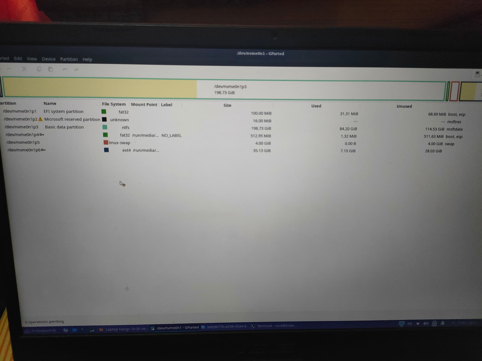

this should be the linux file system.
and this the boot partition.
Yes
I reinstalled them in different order
so looked for the right name in gparted.

Can you show me the image from gparted.
Edit: Obviously /dev/nvme0n1p5 is swap now.
this already gives my username
Please show me the image from gparted of the nvme driv.
Edit: if /dev/nvmeon1p6 is / then that is the first partition that has to be mounted.
