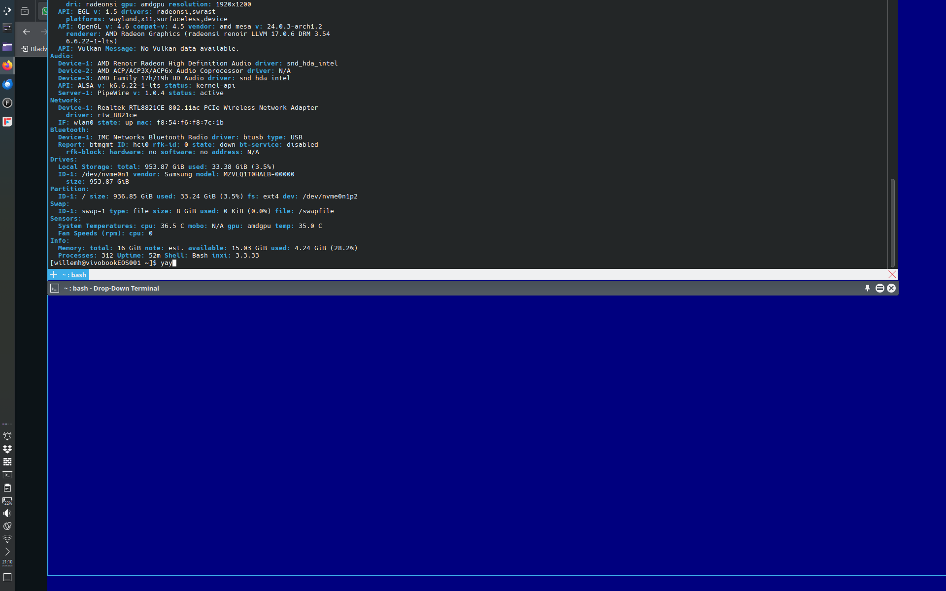

I´m seeing this blue artifact lately on Plasma 6, when I open yakuake; not sure if it’s Plasma, Wayland, or Yakuake that is causing this…
Anyone else seeing this?

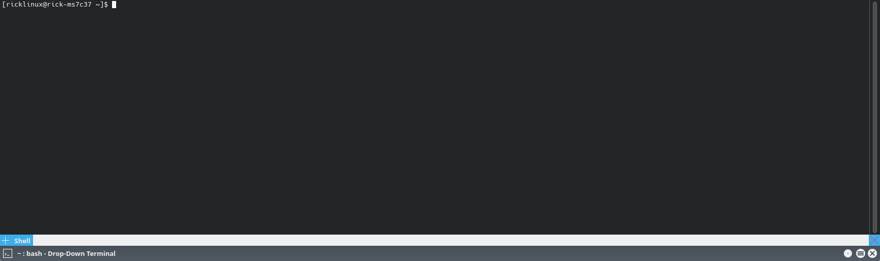

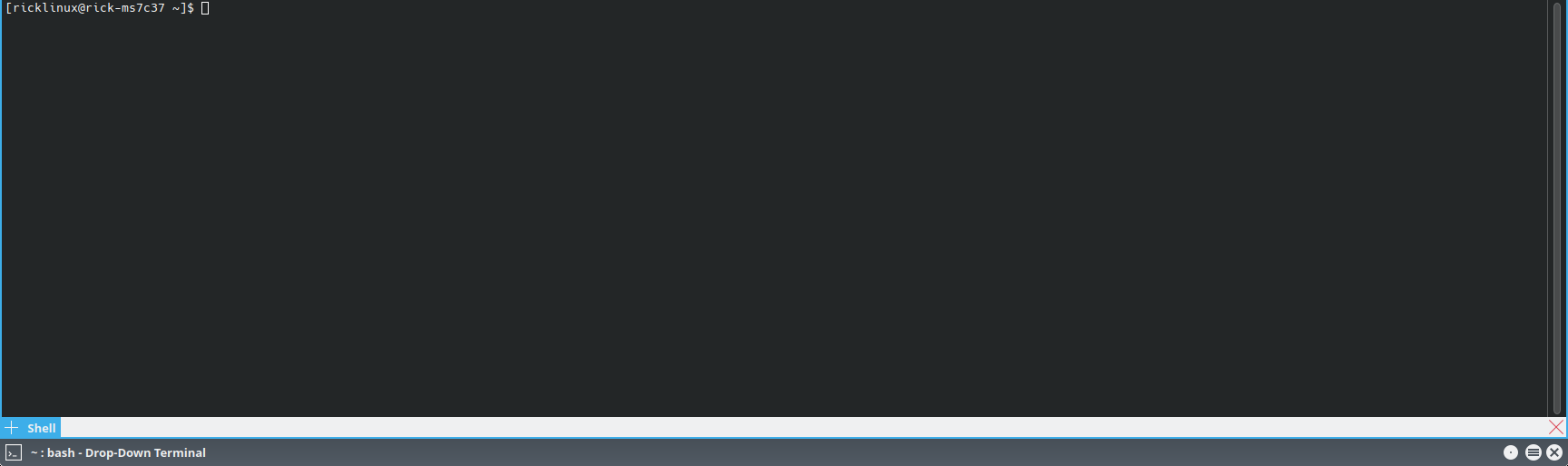

Are you talking about the blue line where it says’ shell? Image provided from my system.
Edit: I went into the menu on yakuake and hide borders. Looks like this now! :thinking:
No, I mean the entire blue area: that should not be there. It is attached to yakuake. When I press F12 to open yakuake it comes with yakuake and if I press F12 again it disappears with yakuake.
Cannot confirm. Never seen this.
Maybe try to change the window size/position in the Yakuake settings and see if something rattles loose? :thinking:
Thanks; tried as you suggested.
Changing the width did remove the blue area - until I closed and opened yakuake again, then the blue area was back.
I see you already filed a bug report. :+1:
Looks like some graphic glitch. Out of curiosity: have you tried a different skin?
On me? No, but I’m old enough to want that :wink:
On yakuake: tried it - made the blue area go for a but, until I did SHIFT-F11 (yakuake on full screen) and F12 twice, and SHIFT-F11 again, then the blue are was back.
Looks like it’s connected to SHIFT-F11: if I have yakuake on full screen and then close it (F12) en open it again with F12, then yakuake is not full sceen anymore, and the blue area shows up.
