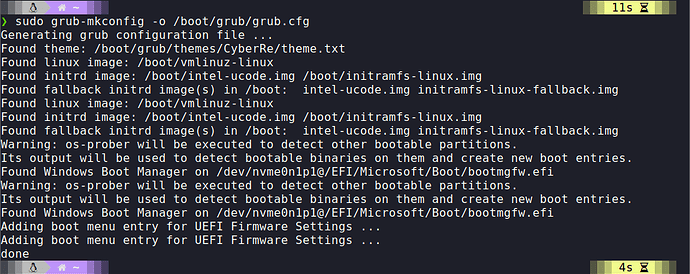

I’m getting duplicate entries in GRUB, even for Windows & UEFI (so probably not due to multiple kernels as suggested here)
I’ve been ignoring it since a long time thinking it’ll eventually get fixed by an update.
Can’t seem find a solution, let me know what info to provide.

Can you post the /etc/default/grub and /boot/grub/grub.cfg?
hmm - the os-prober finds the OS for two times…

Have you, by any chance, used Grub Customizer before?
I had used grub-customizer long ago, broke grub, chroot-ed & repaired grub, been using fresh grub for about 6 months & then this happened.
have a look into etc/grub.d
it seems there are two skripts 30_os-prober ? (os-prober and os-prober_proxy)
if this is - you should disable the os-prober_proxy (make NOT executeable)
I guess the duplicate entries will disappear

Check the files in /etc/grub.d/* and remove (after removing the customizer package, if not yet) the respective files.
sudo pacman -Rcns grub-customizer
pacman -Qo /etc/grub.d/*

Yep, judging by your old .cfg it seems like these files caused the problem.
There are sections for all your entries plus your entries_proxy.
I would remove them.
