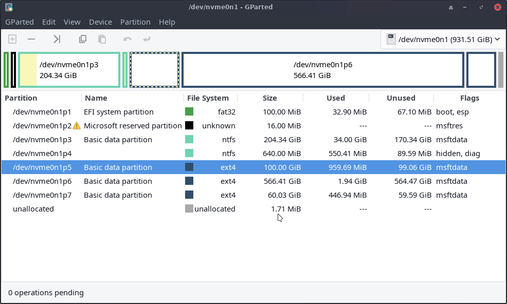

I don’t see any issue with the disk layout.
I dont see option to do that. There is only right click > Manage Flags
It is showing your all partitions from nvme0n1p3 to nvme0n1p7 are ntfs.
Linux partitions should not be ntfs, but e.g. ext4.

So if what @manuel is saying and that could be true because i normally have the partitions created first and formatted. You could just open gparted and format them to ext4 first i would think. Then run the installer.
Edit: I would have thought that the installer would just format the ntfs partitions when it installs but maybe not.
Edit: I only know the layout is no problem.

Yes, but I’m formatting to ext4 in installer, and now even before launching installer formatted to ext4. Still erors out.
msftdata flag on ext4 partitions? should that flag be removed? ![]()
I think what i would do is use gparted and delete those three partitions and recreate them in gparted and format them ext4. Then close gparted and run the installer and go through the manual partitioning and mark and tag them again including efi,
So im just talking about deleting
/dev/nvme0n1p5
/dev/nvme0n1p6
/dev/nvme0n1p7
Then recreate them and format.

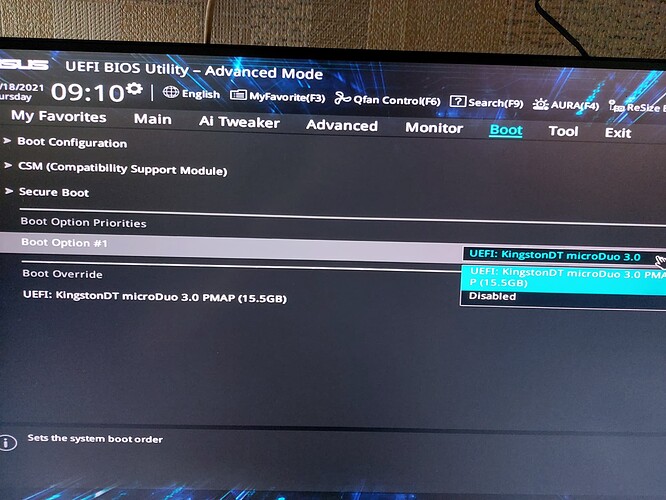

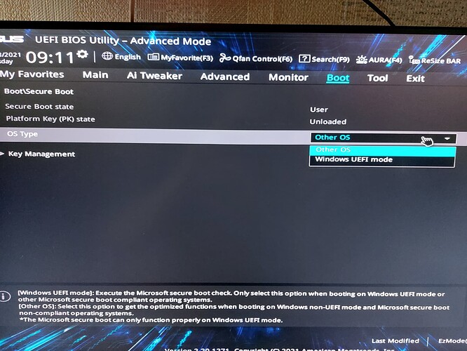

Just a quick question. Did you make sure secure boot is disabled in the UEFI Bios before you started and installed Windows. I know this is a new computer so it may have slipped your mind. Secure boot has to be off. (disabled)
Edit: This is the only thing i can think of right now.
Edit2: If you did then i would try what @pebcak suggests.
Turn off secure boot and you could set it to Windows UEFI mode.
Edit: Then reboot and see if it boots into Windows okay.
