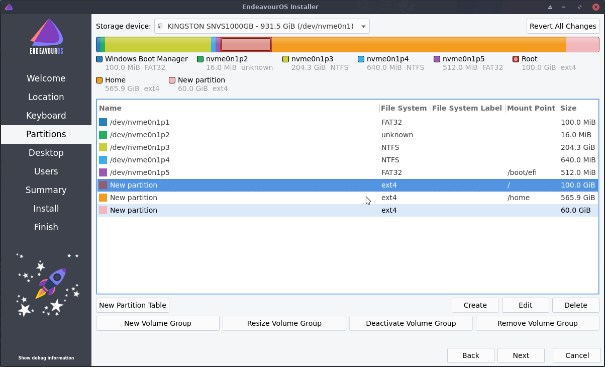

I think you should try what @pebcak suggested and try using another efi partition for eos instead as it will find Windows anyway with os-prober.
new_efi
This is what I setup. Should be fine? No error btw.

If there are no errors now then hopefully it will install now. It probably has something to do with the efi partition and Windows secure boot settings when you installed Windows and it’s not letting it write to the efi partition in Windows? :man_shrugging:
Edit: This is my guess anyway.
The partitions look good!
Did you go through the installation now? Everything got installed?
Yes as @pebcak said this looks good!
