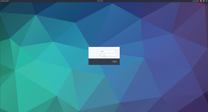

If I could jump in…I’m a new user and I’ve been struggling with this. I had Deepin installed, then started facing problems with the dock not loading (being discussed in the DDE area) and decided to switch to XFCE (had to re-install but that’s another story). Now up and running with that, I’d still like to have Deepin available…so I’ve installed that via the terminal…
But I still can’t find the way to switch between the two DEs. If this was an Ubuntu OS, I’d be logging out and making the switch via an icon next to my name at log-in. For EndeavourOS, I see Change Display Manager in the Welcome screen and I’ve opened Select Display Manager (while in XFCE) but all I see there are the 4 choices (gdm/lightdm/lxdm/sddm). I do not see sessions that you say can be selected.
Hello @DPool
A display manager is not a desktop. In order to have another desktop you have to install one.
https://endeavouros.com/docs/pacman/how-to-install-desktop-environments-offline-install-users/

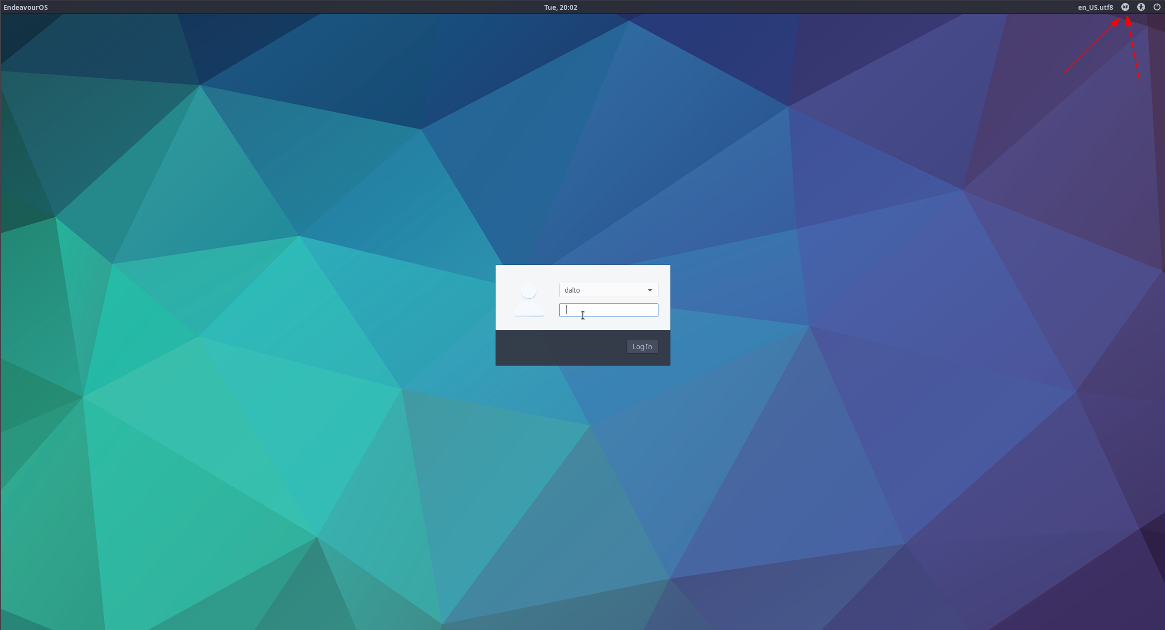

That is where you select the session. You just have to know where the button to select your session is:
It is probably too high resolution of a screenshot, but see the arrows in the upper right.
I guess I was not clear when I said “I’d still like to have Deepin available…so I’ve installed that via the terminal.”
So, yes, having watched the entire process unfold before my eyes (with no signs of errors), I have reason to believe I’ve installed Deepin. Making it available to switch to…if I knew how to switch to it.
(Added) And I have consulted the page you provided many times today (which is not to say that I couldn’t have missed something or done something incorrectly)…but I have at least attempted to RTFM.
Question: Did you read the post directly above yours with the big screenshot? :wink:
I think you posted that at about the time I posted my follow-up…so, no, I did not see that one. Thanks for showing me where the button is…somehow I was in a zone thinking the button was contained in the login box. I bow in your direction!
Sorry if i misunderstood you. If you have already installed another desktop you just switch to it before logging in. Top right corner as @dalto has pointed out.
Yup, got it (how much more hidden could that dang thing have been?)…and it even works! Only…because of today’s developments, there is still no panel and dock. But at least now I can keep an eye on it for fixes while not having to depend on it as my one and only DE. Thanks!
