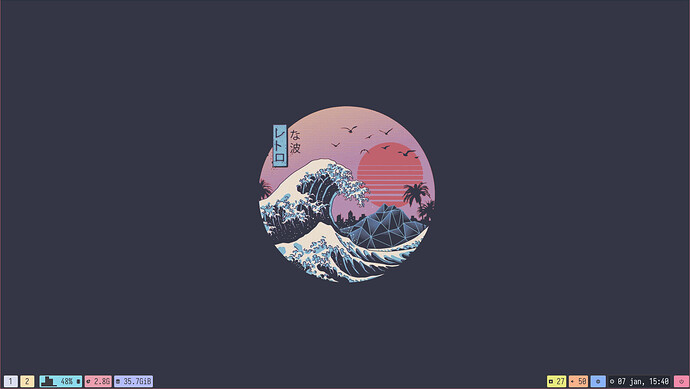

I followed the installation guide of hypr/sway onto Archcraft but missed the pure rofi (not wofi). Instead of tinkering I give Arco Hyperland a shot and it takes the lead now. (‘retro wave’ in the wallpaper)
