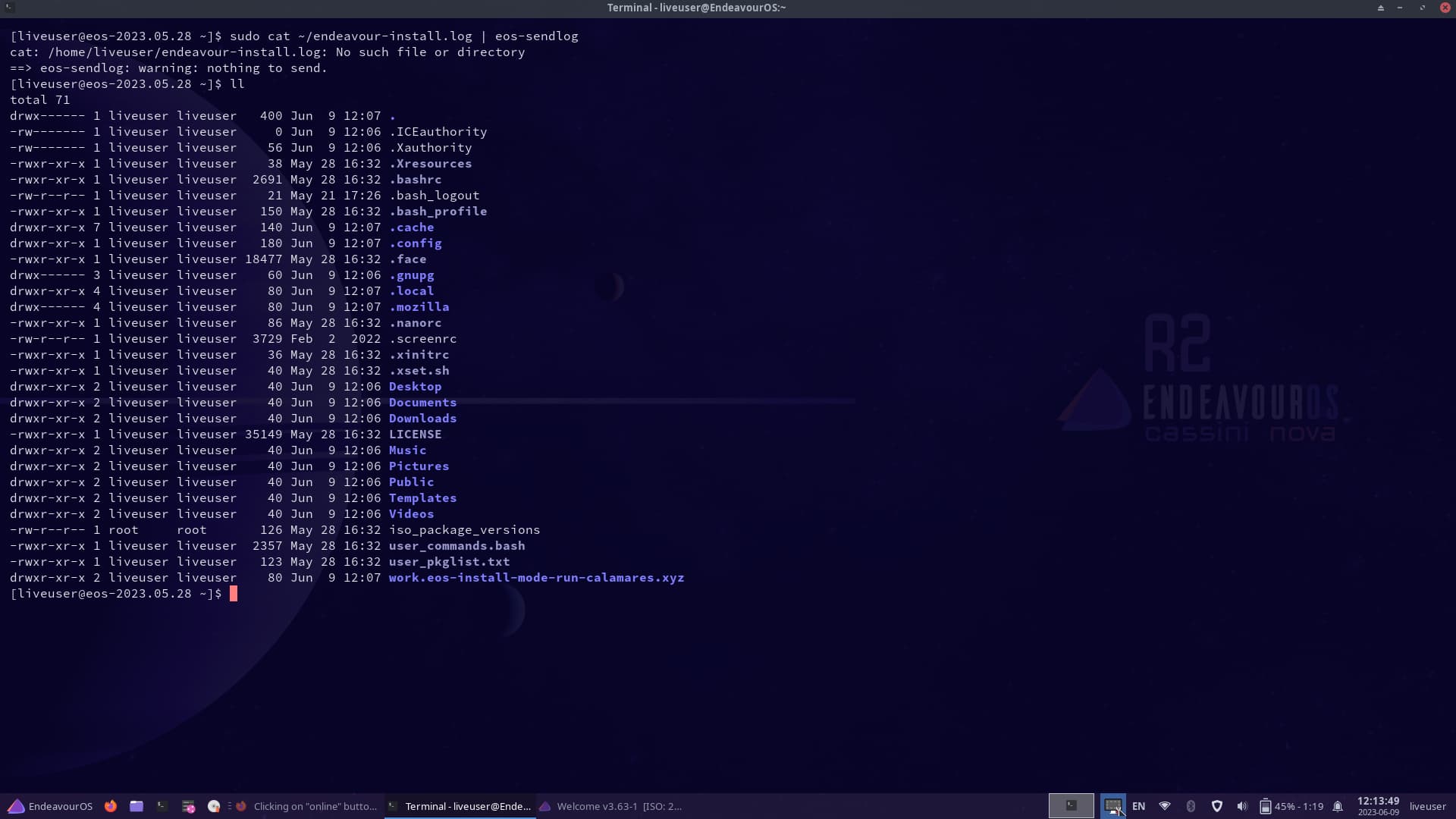

sudo cat ~/endeavour-install.log | eos-sendlog
does anything.
The above command gives the following output:
cat: /home/liveuser/endeavour-install.log: No such file or directory ==> eos-sendlog: warning: nothing to send.

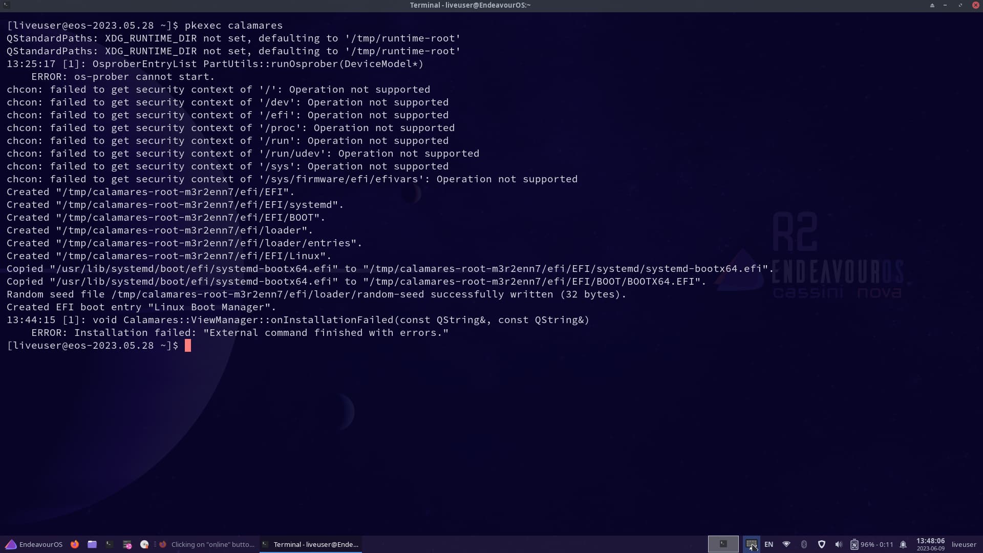

and in case you are on the livesession… you can try starting calamares (installer application itself) manually from terminal to see if it shows errors?
pkexec calamares

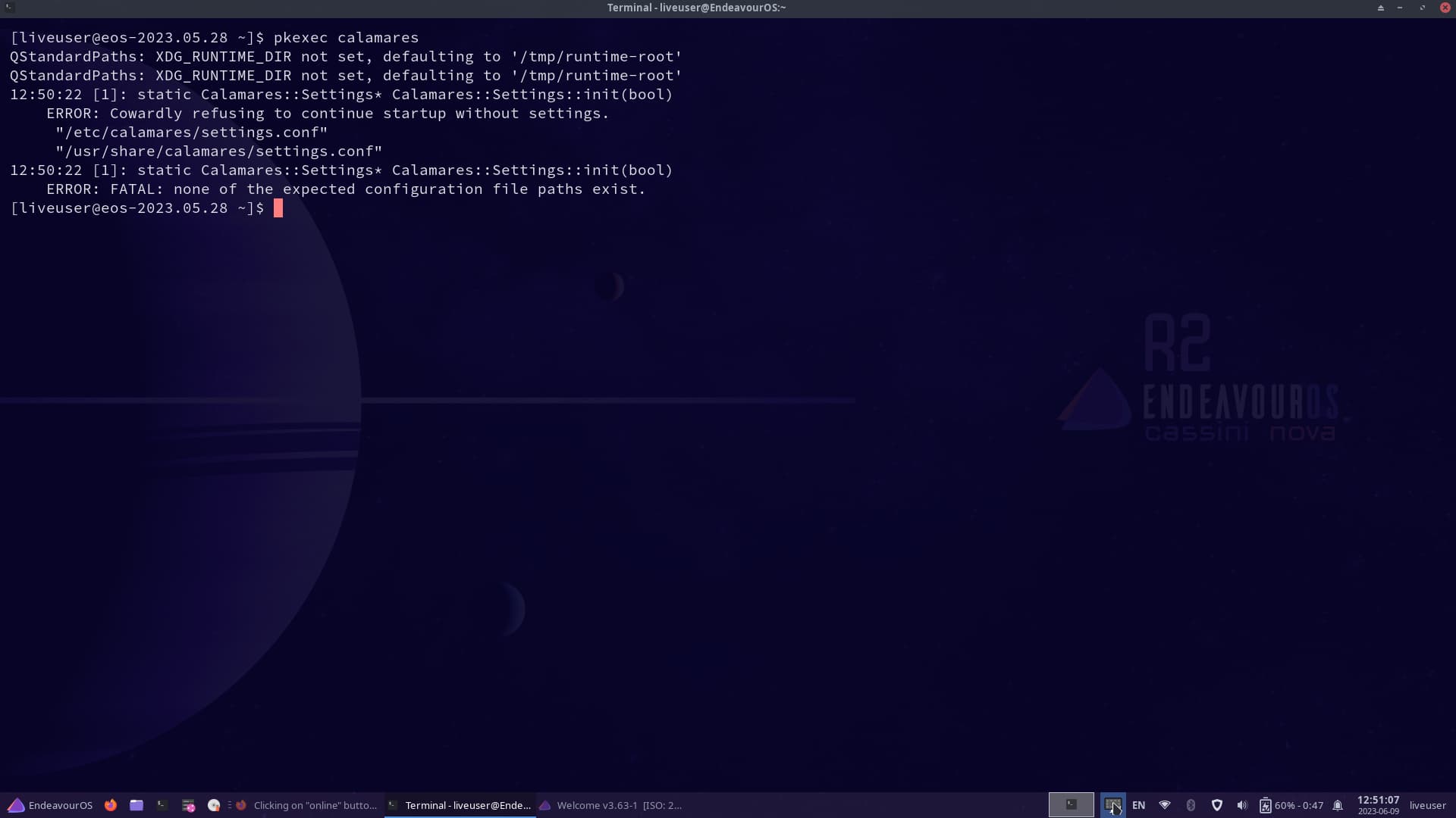

Yes there is an error:
so issue is with the welcome app of some kind… it should copy the needed config when clicking on online / offline…
try this:
sudo cp /etc/calamares/settings_online.conf /etc/calamares/settings.conf
pkexec calamares
Thanks for helping with getting info here could be there is some BUG around the issue… its the second time someone reporting similar…

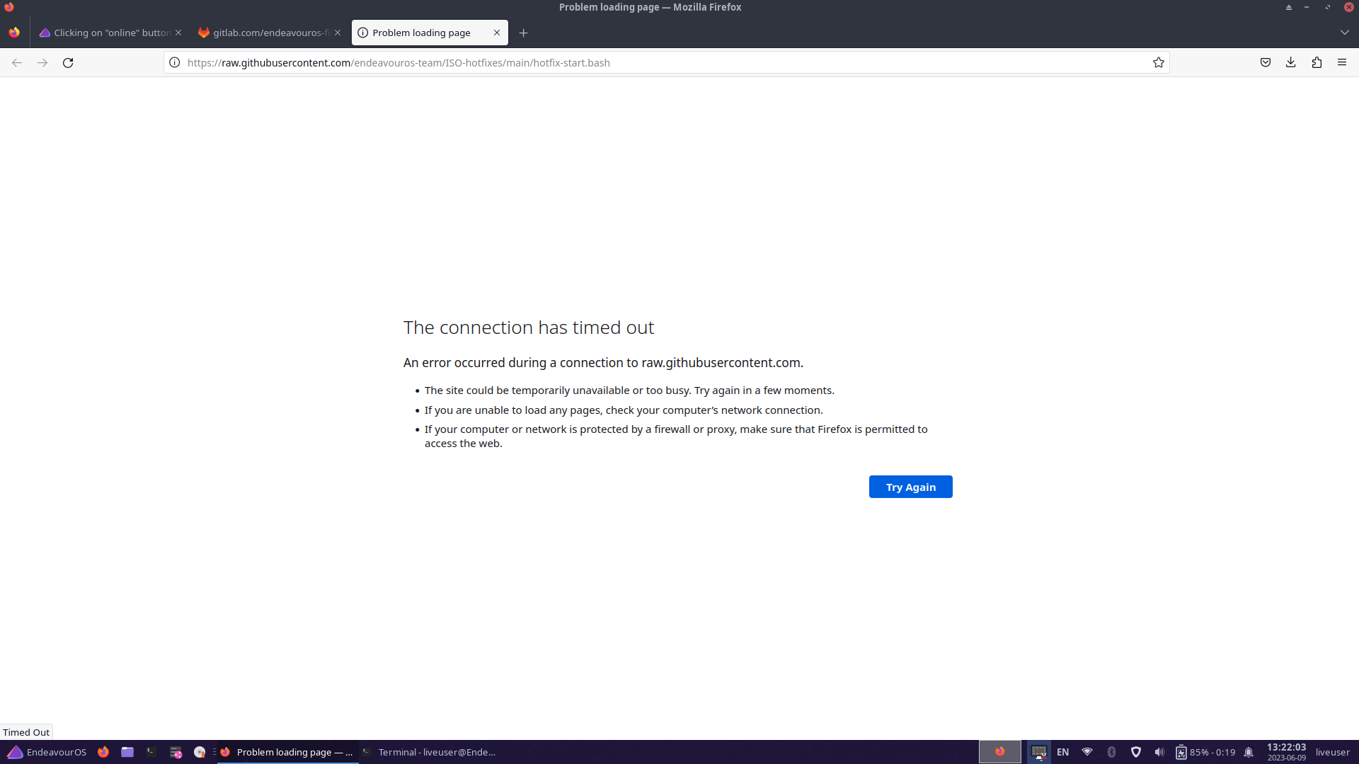

my guess is that may github or gitlab is blocked in your country?
can you reach this file:
https://raw.githubusercontent.com/endeavouros-team/ISO-hotfixes/main/hotfix-start.bash
https://gitlab.com/endeavouros-filemirror/ISO-hotfixes/-/raw/main/hotfix-start.bash
I am from India,
Yes Gitlab is opening. But
Github is not opening for me, it is stuck on loading screen
Well I was facing this github issue for many other repositories and the content like image and pdf was not loading for me. Might be the India case here…
At last the github page did not load and says : Problem lading page
After i downloaded the system at last it says : Installation Failed
and gives me this link
https://termbin.com/43wu
Now what to do ??
I don’t know what is going on.
