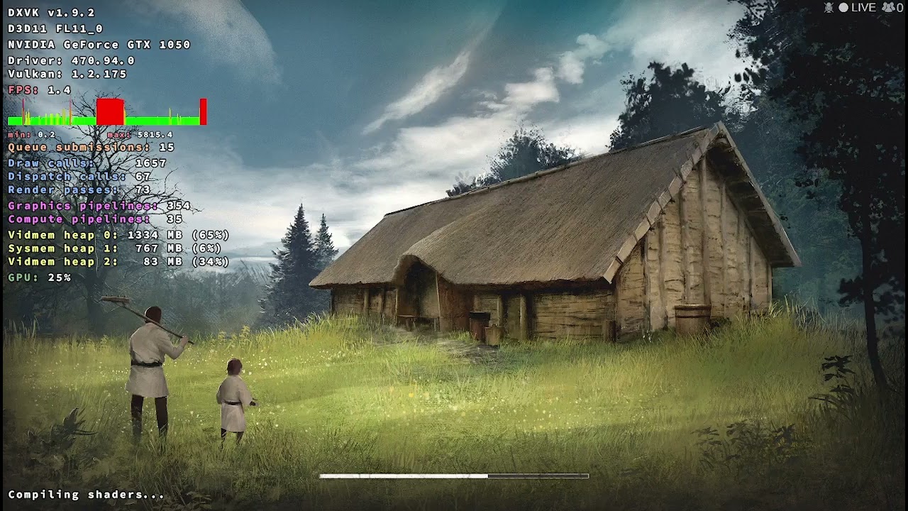

I got rid of 495 version and I installed 470 version, but I’m still having low performance issues. I just recorded a Medieval Dynasty clip using the env variable DXVK_HUD=full %command% so you can see more in detail:
Well…Looks bad, looks like it’s specific game + proton problem after all.
Do you have any other game to test and see if it’s an anomaly?
