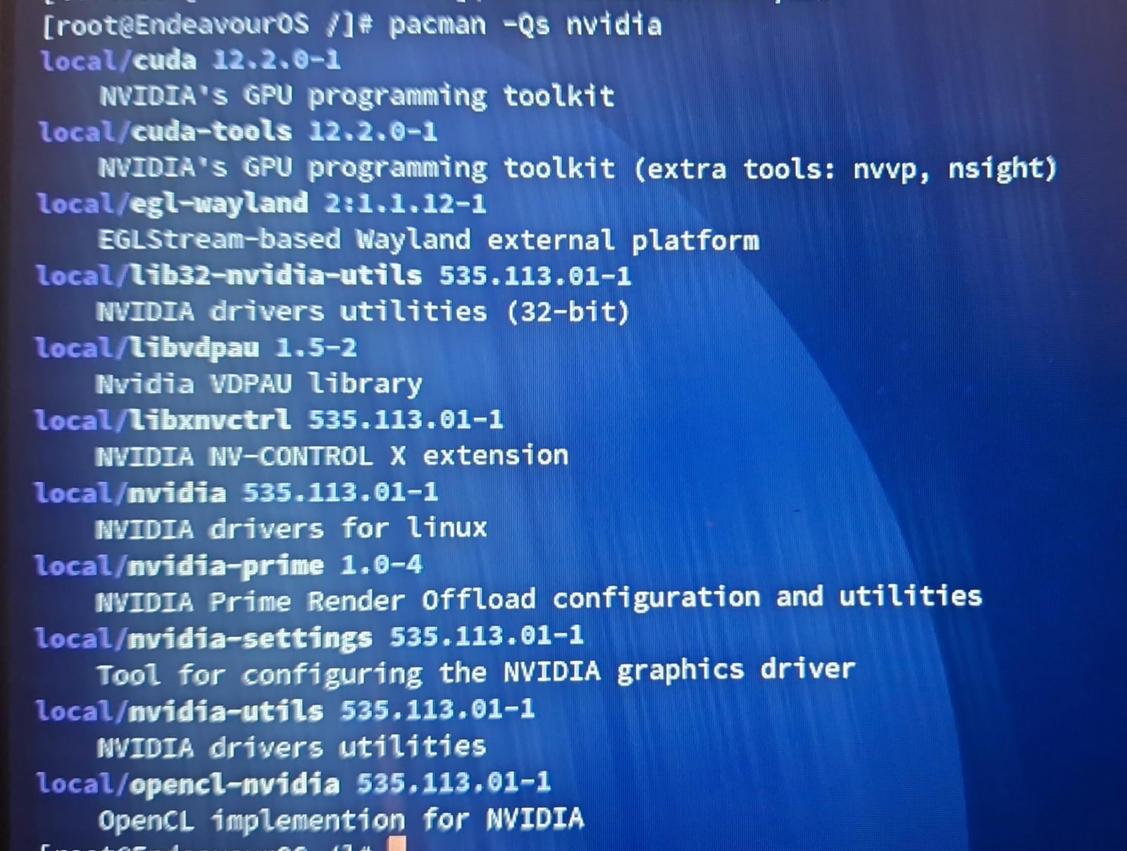

I did have them before the upgrade, but when the problem occurred, I deleted them following suggestions on the forms, but it didn’t work, so I installed them after I removed docker, thinking that the black screen appeared because I didn’t have Nvidia drivers anymore.
This image might be helpful, this is the current list of Nvidia packages that I installed
EDIT: I access arch-chroot from live ISO usb
EDIT 2: I tried to run without them, except one due to long trail dependence on it, I think it’s libvdpau
It doesn’t show nvidia as installed in the hardware info you posted. If you arch-chroot you could try the folowing.
