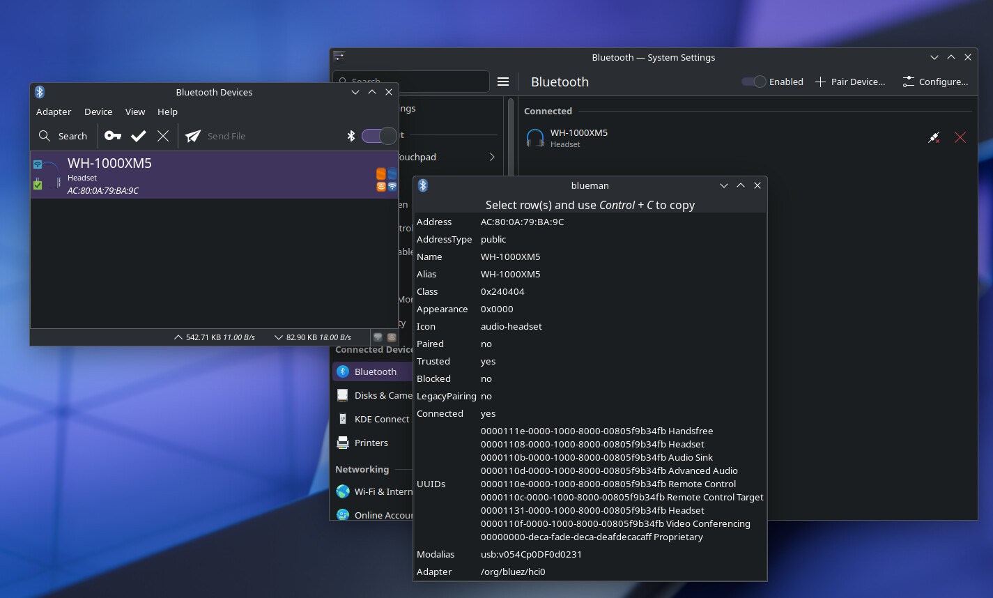

I tried following those steps. At first it failed to connect (timeout). After trying again, it said that it connected, but it’s not showing up in audio settings. Pretty much similar to what I described with blueman.
I’m gonna try reinstalling with KDE instead. I’ll report back if that helps.
Edit: This did not make much of a difference. On KDE it just fails to pair after 30 seconds. Additionally, my mouse won’t pair either.

Oddly, it’ll say in the settings menu that it’s connected, but the bluetooth window will say that it failed, and then where it said it connected will just go away and still say that there’s nothing paired.
Really getting mixed signals here. Connected but not paired?
Few seconds after posting that screenshot here, got a notification saying that pairing failed.
