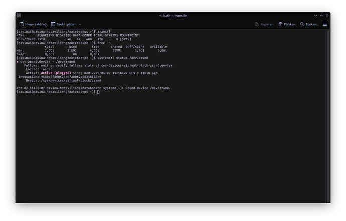

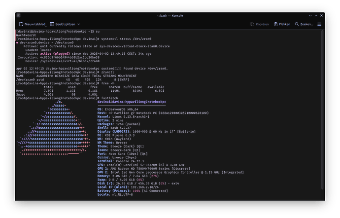

The output is now:
To my understanding zram will not work well with a swap as stated in the arch wiki you need to disable it. If i use the command echo 0 > /sys/module/zswap/parameters/enabled and reboot it gets re-enabled again (probably because a swapfile is created).

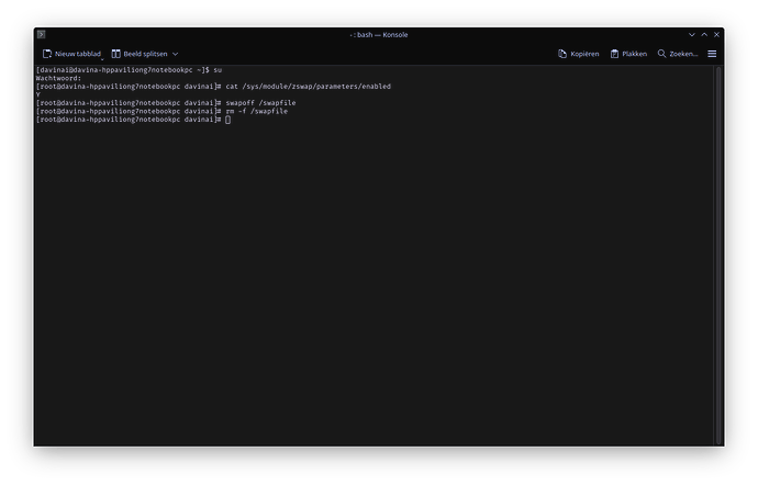

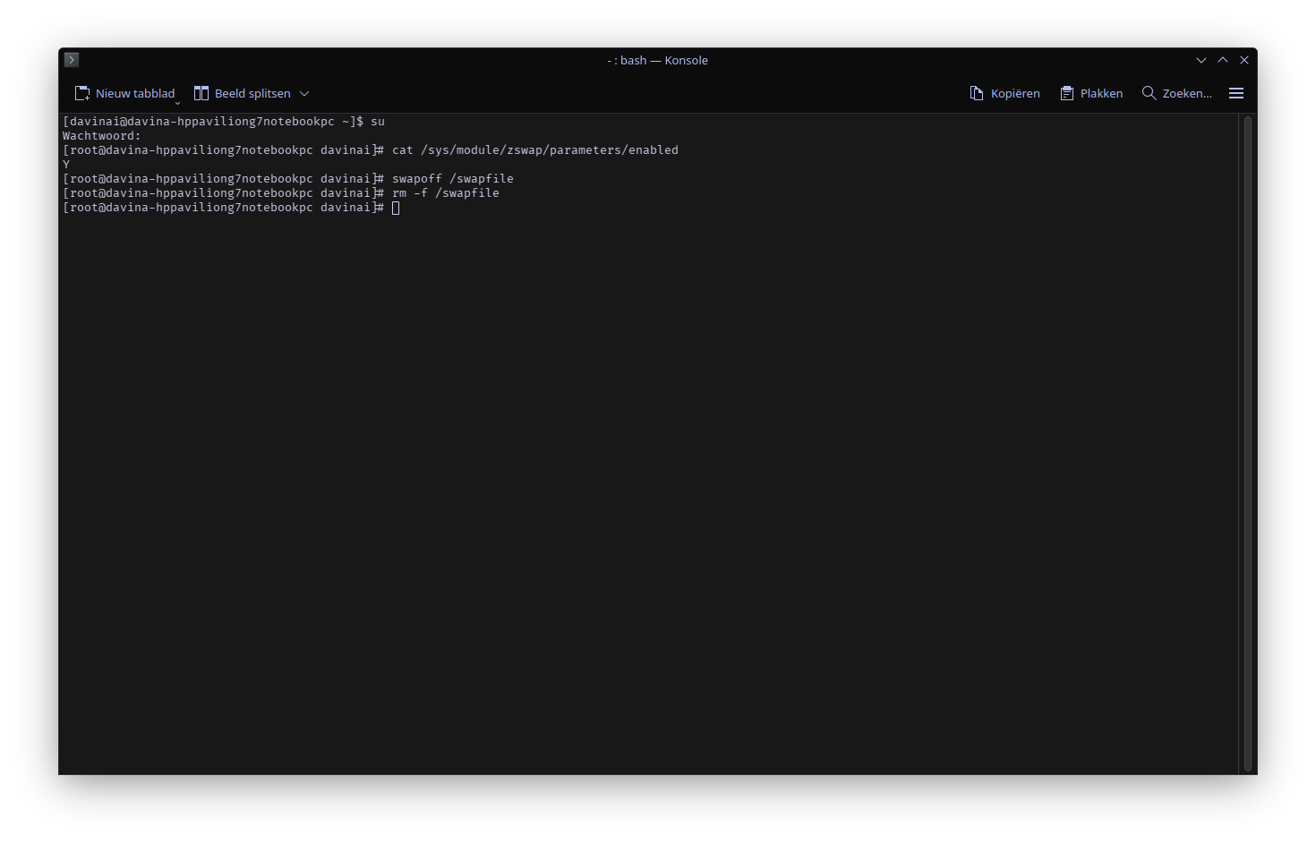

So now i removed the swapfile with these commands:
Rebooted and i get errors back

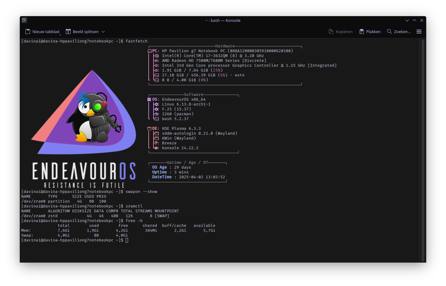

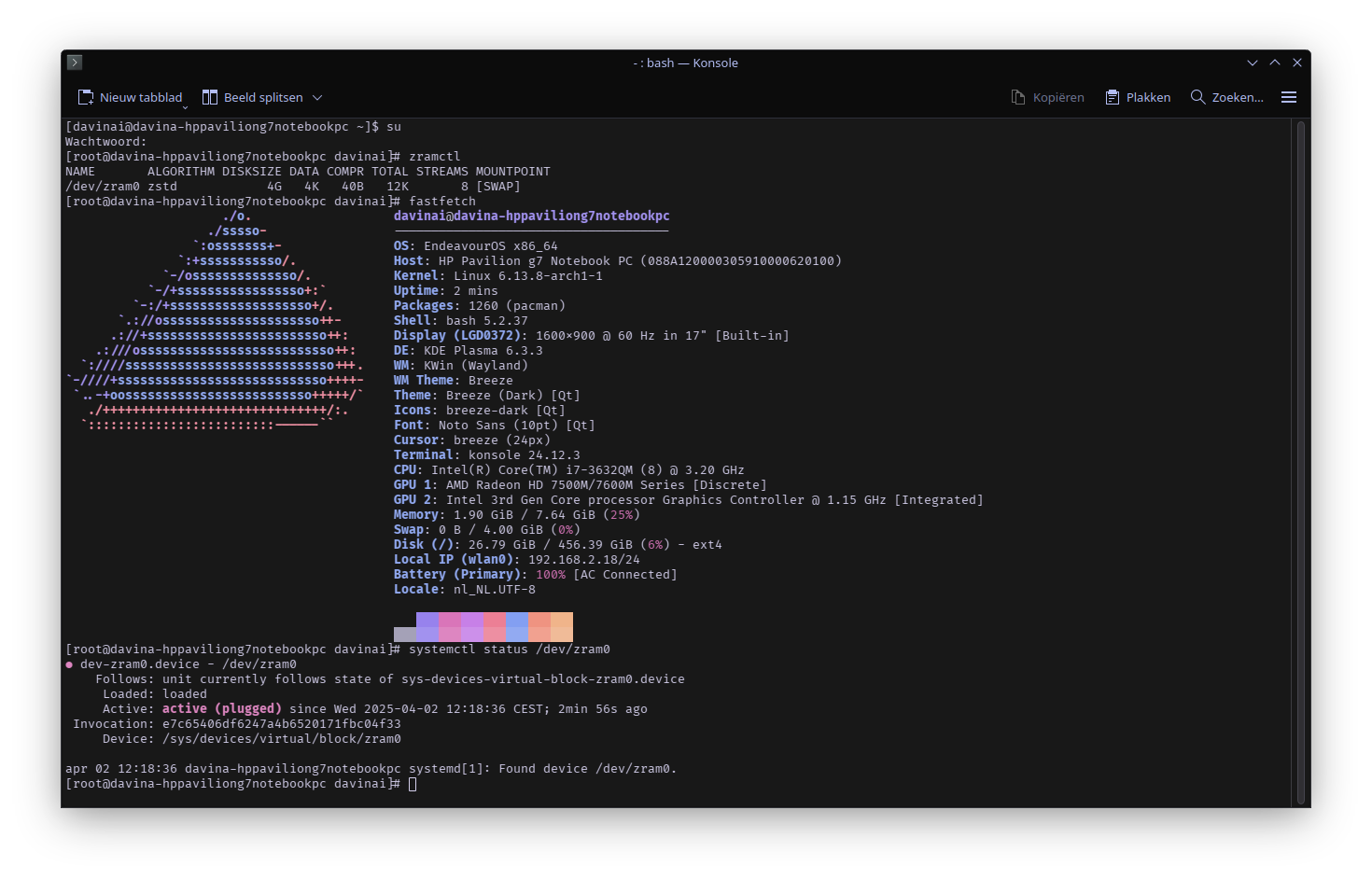

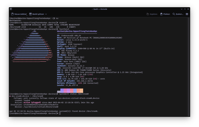

Where in the last picture is the error?
reading it it says there is no swapfile…i removed the swapfile to check if the zram issue would come back. I did not remove the swapfile entry in fstab. :sweat_smile:
Edit: it’s very weird, seems everything got fixed after adding and removing the swapfile. zram also has a mountpoint.

Anyway seems starting over worked, i removed everything related to zram. Installed a swapfile 4G, installed zram later. Rebooted an voilla it worked, removed the swapfile and it still works. From early screenshots i posted i do notice now that zram has a mountpoint…it did not have this before.
2 Days ago (before i got updates) it did had a mount point → Zram vs swap partition vs swapfile - #83 by MichelN
