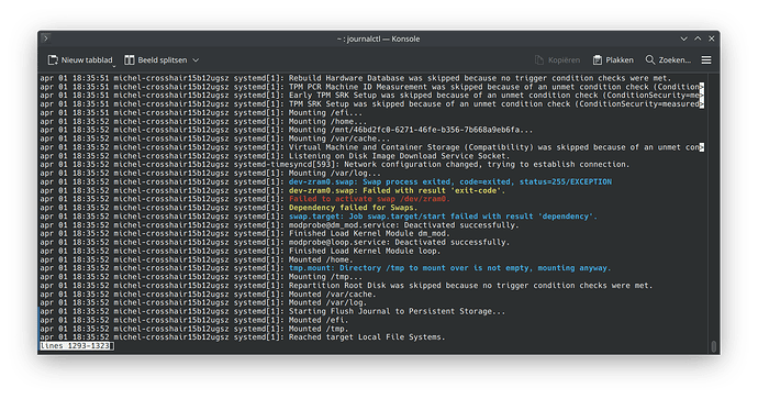

Zram errors after last updates

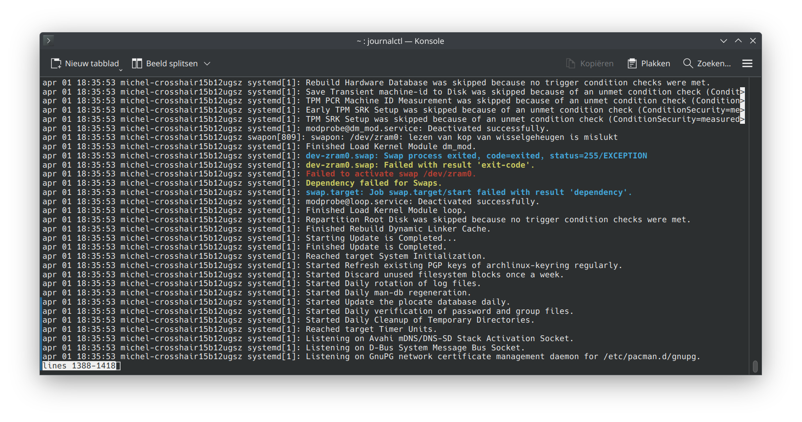

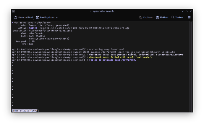

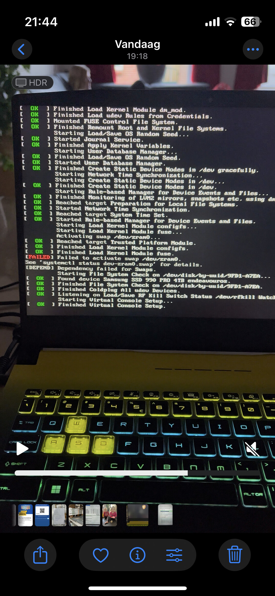

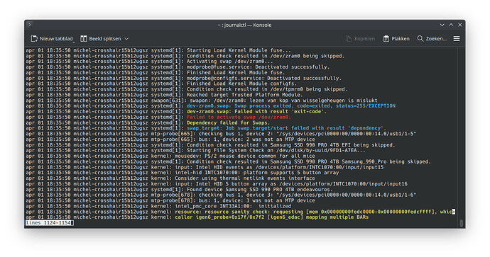

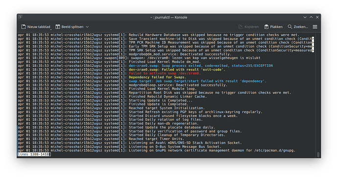

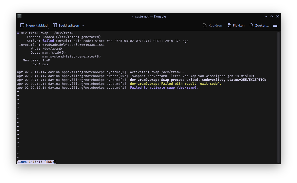

Since i disabled it my zram is not working anymore.
How did you enable it? What’s the error message?

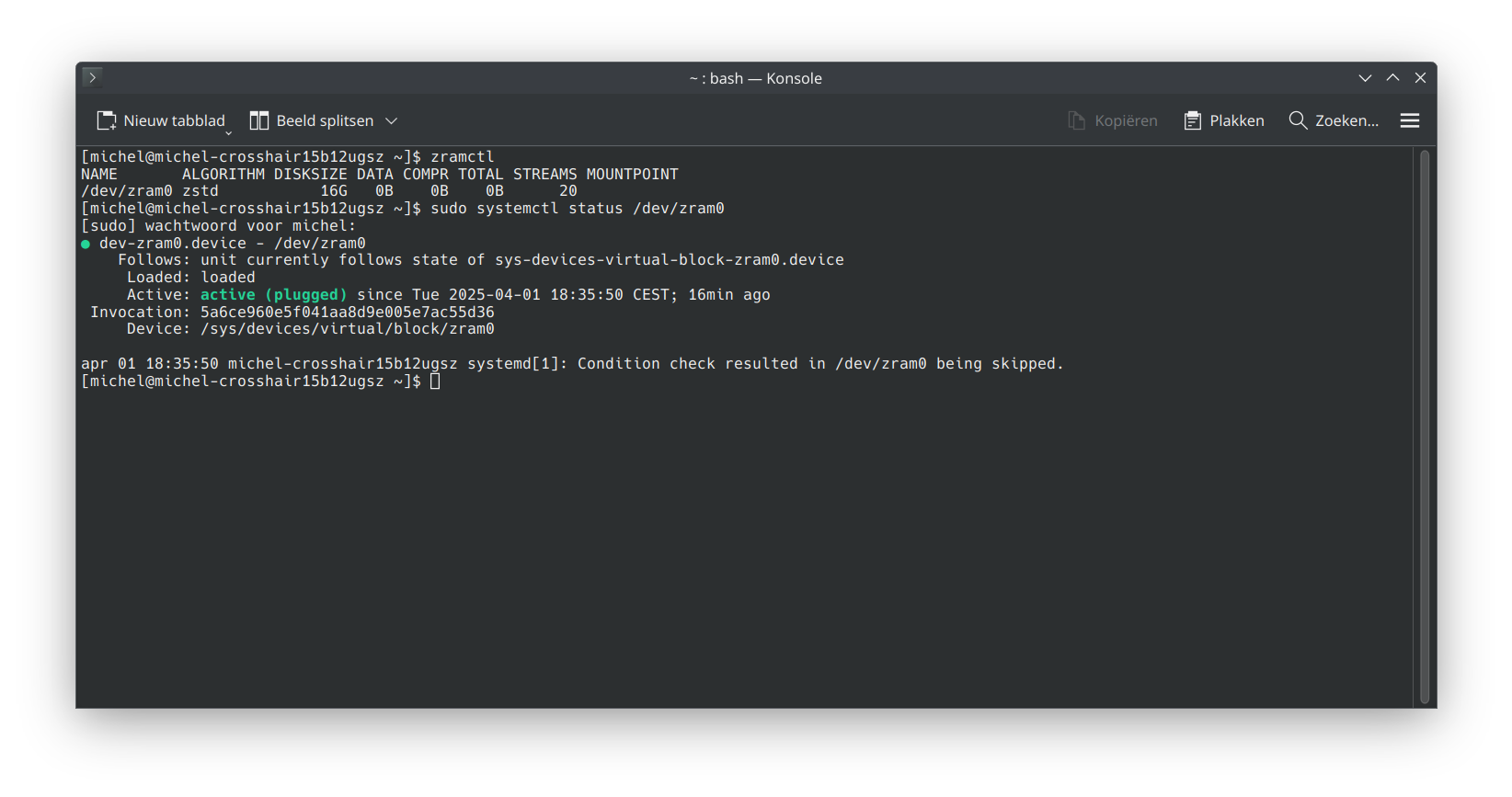

I activated it by Using a udev rule and Optimizing swap on zram on the arch wiki

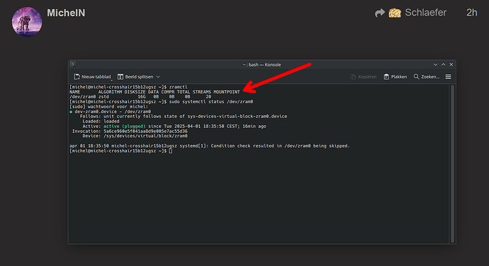

Zramctl clearly shows it’s available?
Then why does it fail at boot ?
No idea. Personally I only used zram-generator, and that always worked. Maybe check the steps from the wiki again.
There is no mountpoint showing for your device. Did you create an fstab entry for it?
I agree that using zram-generator is the simple way of doing it. I also used zram-generator.

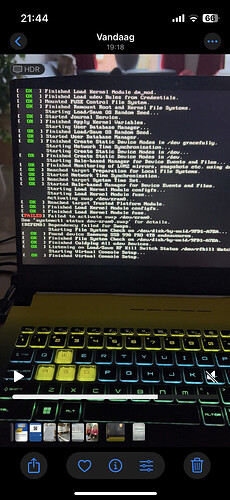

Well i tested it on my older notebook which was working fine for 2 weeks using zram. i ran updates just 2 minutes ago and suddenly the zram is not working anymore after rebooting the machine (while it did during boot before the updates).
It seems a update is causing this problem, any idea how i can trace this back to which update ?
@joekamprad
I used the arch wiki to setup my zram. Yes fstab is included.
/dev/zram0 none swap defaults,discard,pri=100 0 0
The issue started after updates today since i tested it on another notebook which had no issues till it got updated today.

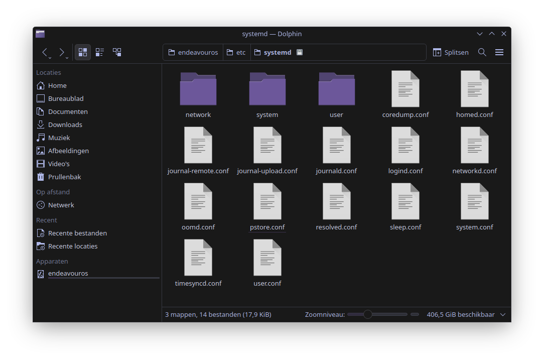

/etc/systemd/swap.conf ?
I also followed the wiki and used zramswap, not a udev rule. In my case /etc/fstab is not needed.
Swap: 3.1Gi 0B 3.1Gi
You can see your latest updates in file
/var/log/pacman.log.
I misunderstood your message, well i do use fstab and now want to figure out which updated caused this.
Thanks for the info
Thanks will look into it.

Not available

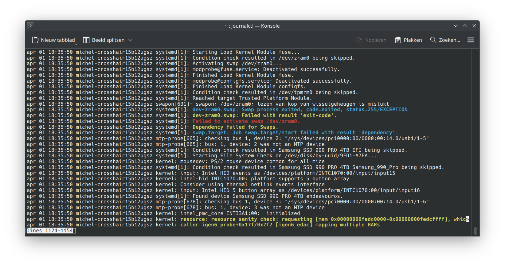

Here is the error output
It’s not needed, but yes, it should show something, I have this :
01-04-2025_22-53
Follow the error message, type the command :
systemctl status dev-zram0.swap
It maybe will tell you what’s wrong.
At this point, can you post a full journalctl -b?

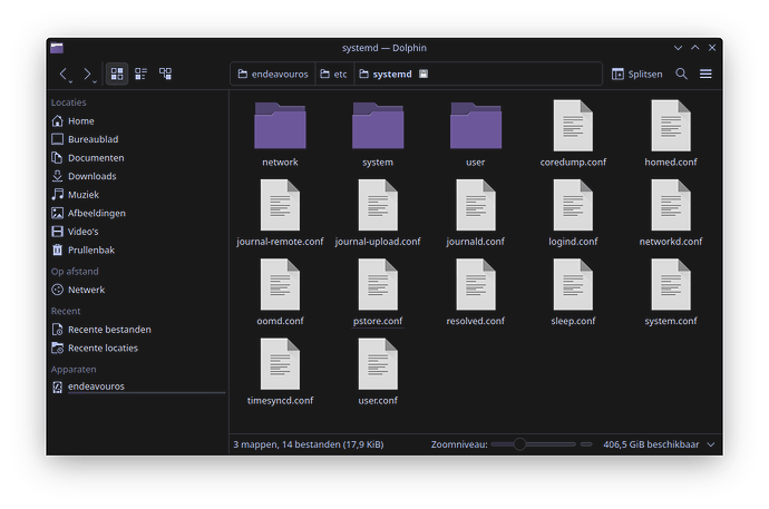

Also, just to be sure:
  • cat /etc/modules-load.d/zram.conf
  • cat /etc/udev/rules.d/99-zram.rules
Well i removed the zram.conf and 99-zram.rules and wanted to try the zram-generator as suggested. Even that one fails which is so weird.
