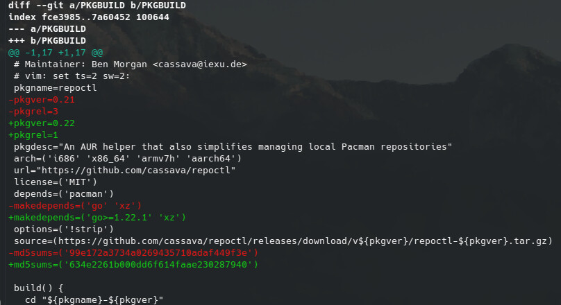

I avoid it cause it doesn’t just list the differences, it list everything in the file to be reviewed. I like yay and pikaur can they only son the differences make it far faster to review.
That isn’t true. With both yay and paru, the first time you build an AUR package, they show you the entire file because they don’t have anything to diff against. But on subsequent times, they show the differences.
So if you switched to paru, the first time it will show you the whole file.
Here is an example of what I see in paru when updating.
