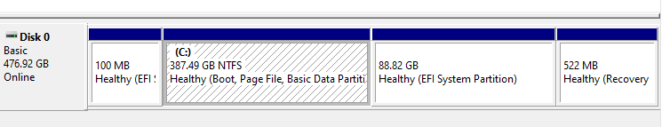

today i attempted to do a dual boot with Windows 10 and EndeavourOS and after installing EndeavourOS successfully, after the restart it just booted to windows instead of GRUB, i tried going into BIOS to change it to the Linux boot manager but there wasn’t one there, just the Windows Boot Manager, i checked Disk Management and the endeavourOS partition is detected as a “EFI System Partition” I don’t know what im doing wrong as Ive done this before many times successfully.

sudo efibootmgr says “EFI Variables are not supported on this system.” and sudo parted -l says
Model: SanDisk Cruzer Glide (scsi)
Disk /dev/sda: 15.4GB
Sector size (logical/physical): 512B/512B
Partition Table: msdos
Disk Flags:
Number Start End Size Type File system Flags
2 2595MB 2760MB 165MB primary fat16 esp
Model: ADATA LEGEND 700 (nvme)
Disk /dev/nvme0n1: 512GB
Partition Table: gpt
Disk Flags:
Number Start End Size File system Name Flags
1 1049kB 106MB 105MB fat32 EFI system partition boot, esp, no_automount
2 106MB 123MB 16.8MB Microsoft reserved partition msftres, no_automount
3 123MB 416GB 416GB ntfs Basic data partition msftdata
5 416GB 512GB 95.4GB ext4 endeavouros boot, esp
4 512GB 512GB 547MB ntfs hidden, diag, no_automount
