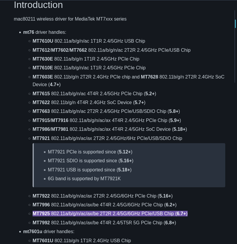

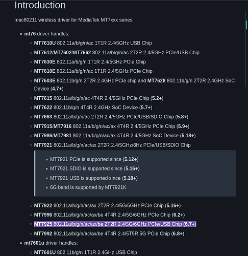

If I understand correctly it should work with the newer kernels. Got “6.15.5-arch1-1”. I see some people having this chip working “just” slow or without BT but wifi general working.

Did the WiFi work when freshly installed and then stopped working with an update? Or it never worked from the beginning? It’s supposed to work with the mt76 driver and it does look like the module is loaded mt9725e.
You can verify if it’s loaded.
lsmod | grep mt7925e
Don’t have much to offer. It could be a firmware issue or something else. It’s a fairly new WiFi 7 chip.
