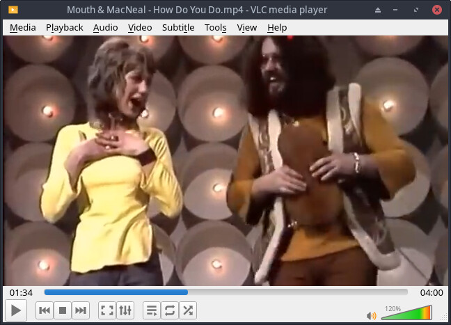

If you upload a file with embedded video or something, i can check. I have only two vlc packages installed currently and they are: libvlc-rpi and vlc-rpi. I have nothing else installed with vlc in it. I used to have a ton of codecs (as you said) installed together with the standard vlc package. They are all gone now.
Well you still have the plugins. The older version of vlc built the plugins internally where you had to install some extra codecs manually for them to work. They were mentioned in the PKGBUILD under optdepends=(). This is how vlc-rpi is built. The new vlc is built using external vlc-plugins and these packages also are under optdepends=() instead of the system codecs mentioned in vlc-rpi PKGBUILD.

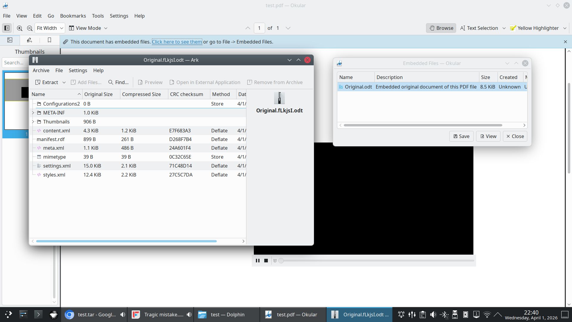

Here is a test .pdf for you to test. It is a 70 year old song of a video with Mouth and MacNeal. I tested it with evince and it works as I run xfce and do not want to install 500g of files to test okular.
It pulls in the external video (also included) and plays it in the document
Unpack the archive
cd to the test directory and open test.pdf in okular and click it’s Play Button.
https://drive.google.com/file/d/1PfZCLn8ZJYH8OT3MJwVDi7FsDBFi81Xa/view?usp=sharing
I am guessing it doesn’t work. But honestly i don’t remember the last time i opened a pdf document with a video attached. Having hw accelerated x265 playback is more important to me at this point.
PS: I tried to play the video file outside the pdf, and it crashes VLC :slight_smile: Why? I installed MPV, it started to play it and instantly crashed right after.
No clue. I have never cared too much for vlc-rpi because of having to jump thru hoops to get it installed and ran into limitations. That is the reason for me building my own ffmpeg for rpi and using mpv. I have very little experience with it.
MPV actually plays the video, but crashes when i make it fullscreen. VLC from the command line gave me the following error:
vlc video.mp4 (i renamed your file to make it simple)
