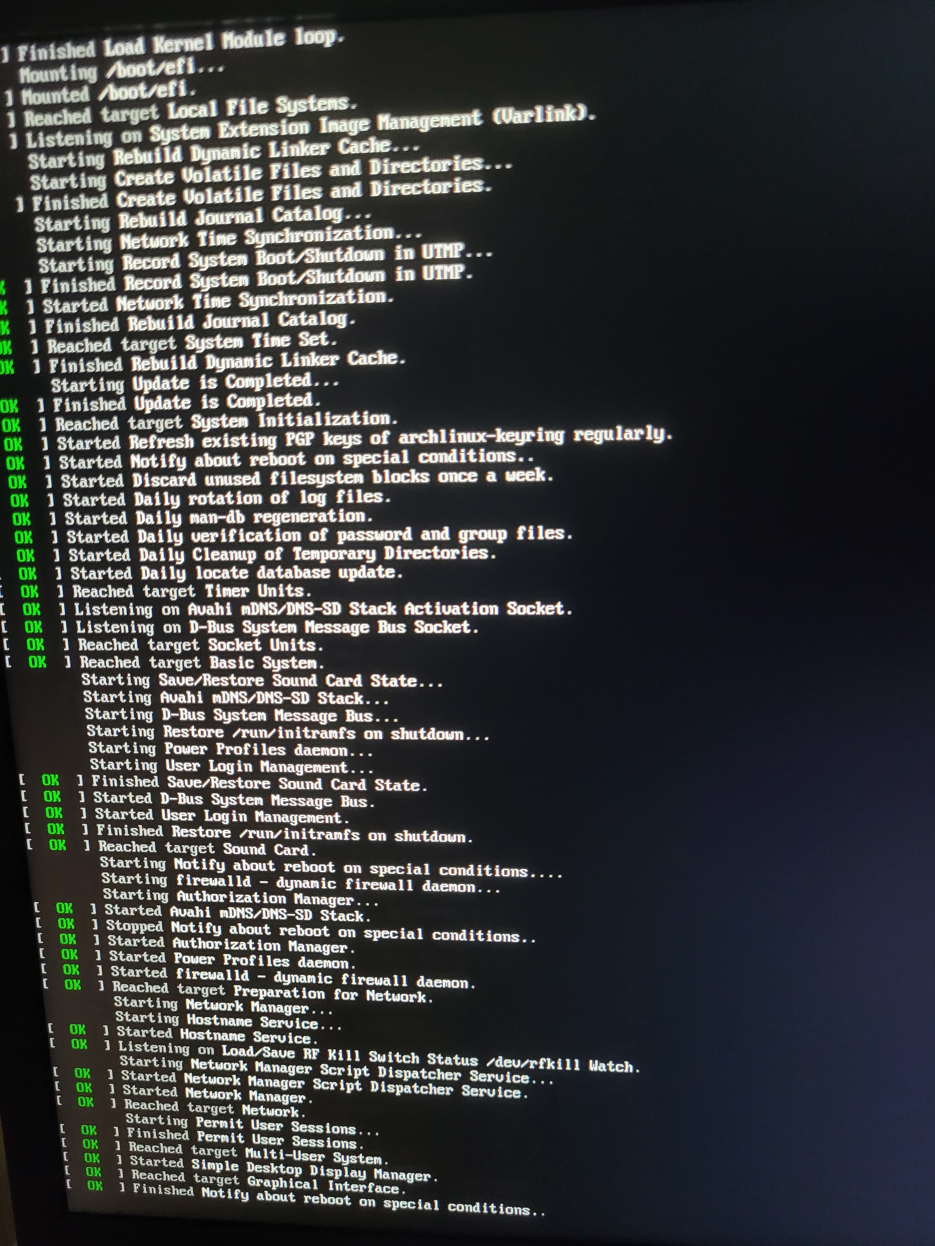

Tried switching to the LTS Kernel, rebooted and have been stuck in the message log screen for like 2 hours.
I really hope it isn’t hardware related! Specially the SSD itself…
Did you remember to install the headers as well?

But no idea why you stuck on LTS Kernel. Can you still boot into your previous Kernel?
I don’t know? All I did was sudo pacman -S linux-lts and sudo grub-mkconfig -o /boot/grub/grub.cfg. Am I missing a step here?
Yeah, booting into the previous Kernel works. Seems like I missed a step, as dalto pointed out.
Yes, you need to also install linux-lts-headers if you have any dkms packages which you probably do.
