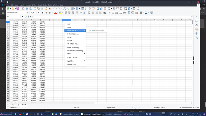

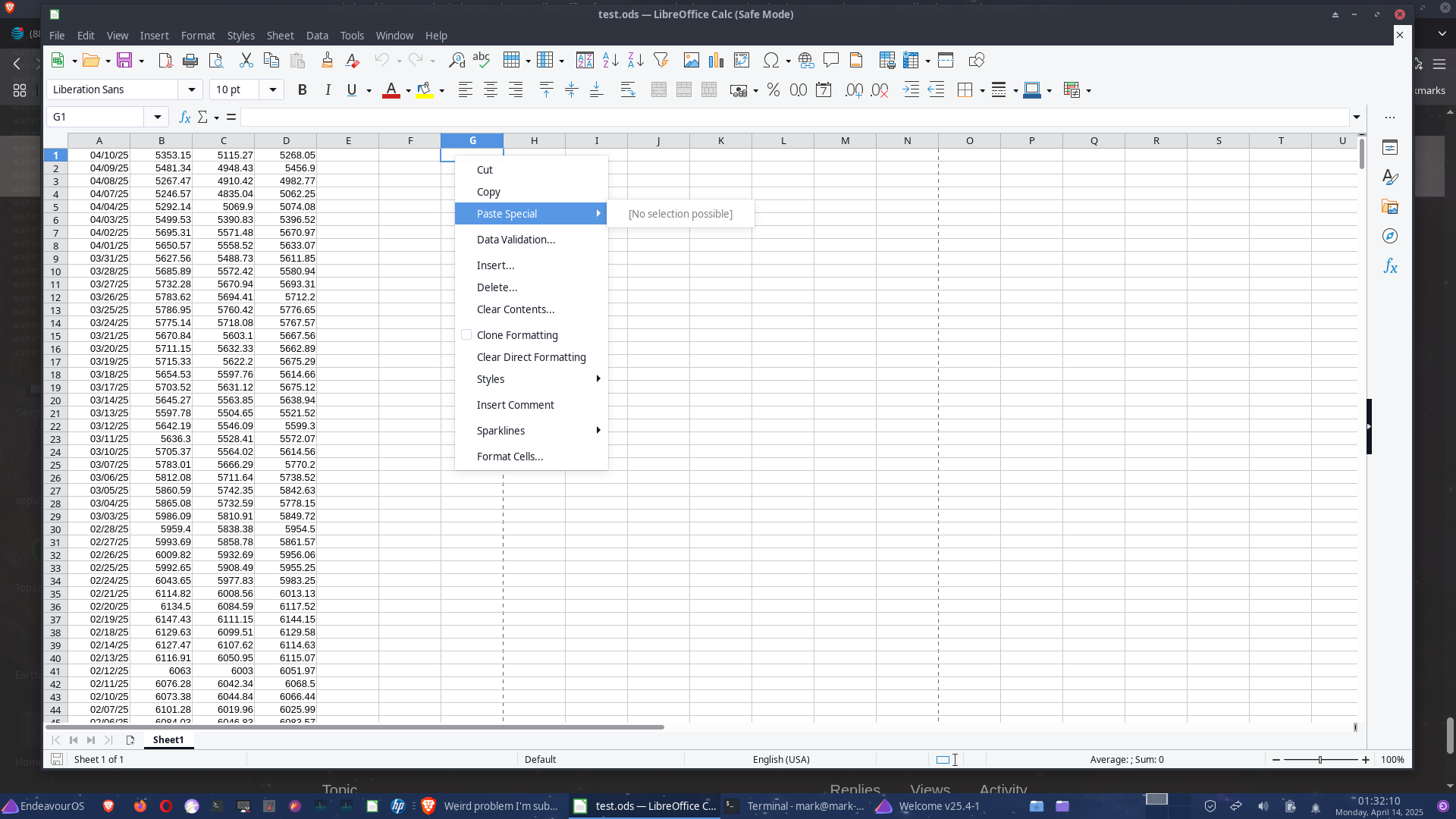

At least initially, you can see the failure mode here, with the paste option grayed out.
IT’S WORKING!
