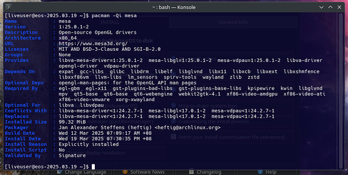

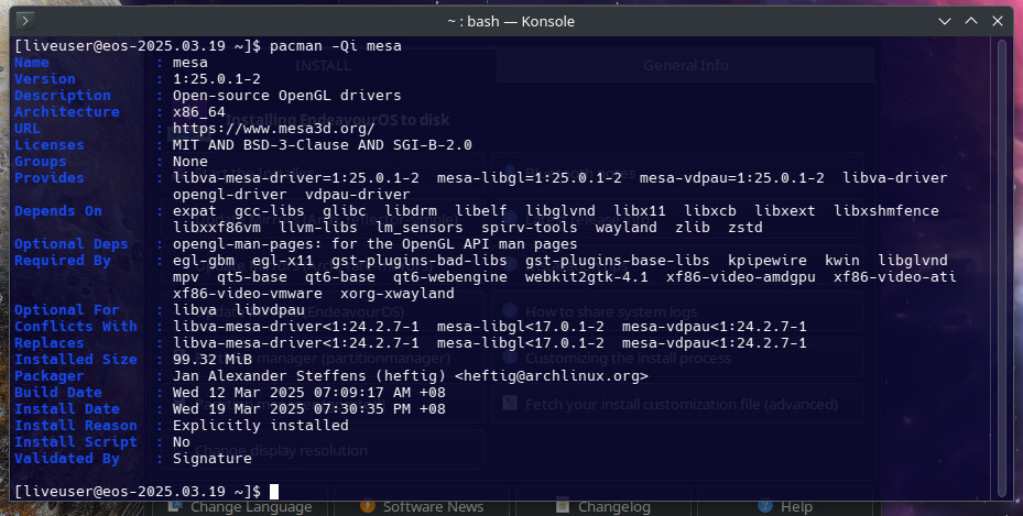

I’m not sure if it’s a mesa issue. I’ve downgraded the mesa version to be the same as the version that comes from the installer. Issue still persist. Anything else that I missed?
Downgraded version in my EOS VM
Version from installer iso
