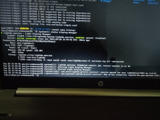

so a bit of an update, i attached an external keyboard while the blinking shenanigans are happening, did ctrl+alt+f3 and the tty prompt showed for a split second before returning to the blinking shenanigans again.
from first command

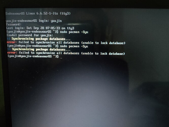

hold up, this is new. i spammed ctrl+alt+f3 on the blinking screen and now im in tty
this is not the snapshot rather the supposedly current update that’s not working

looks like the lock-file was left behind, which prevents the update to run.
try:
sudo rm /var/lib/pacman/db.lck
as per: Update problem - var/lib/pacman/db.lck
i’ll try, the spamming tty technique is not consistent though and i’ve only managed to get it working once (see the attached photos) so im not sure how i’ll go from thereon
update: still can’t manage to get into tty consistently (haven’t been able to do so since i posted the pic). currently using an old snapshot before system update. until i (or we) can find something i think i’ll be using this in the meantime.
