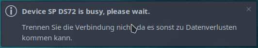

Let’s do a quick example: I insert my “Ventoy” USB stick, open the file ventoy/ventoy.json using less in another terminal, then try to unmount the stick. I get a notification:
Since I know that “SP DS72” is my Ventoy USB stick, lets quickly list block devices:
