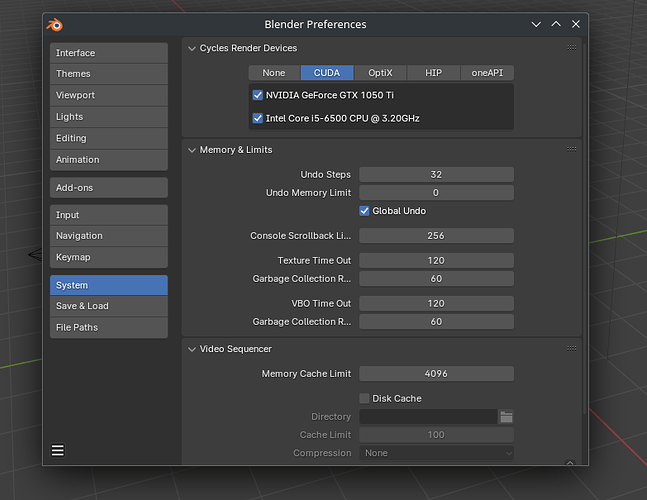

If you have Blender and CUDA installed, you can test it easily by going into Blender’s “System” settings tab.
Or try some other method because CUDA takes a while to download if you don’t already have it.
Installed blender for this :smiley: I have this, idk if it says anything to ya.

Yeah, it looks like Hybrid graphics has been enabled because you would normally see an error instead of your two graphics cards.
You can do a further test by actually doing something graphics-intensive in Blender or another app while having your system monitor open to see if your Nvidia GPU gets used.
It is, I played world of warcraft, and it was utilizing from my Nvidia yeapp.
