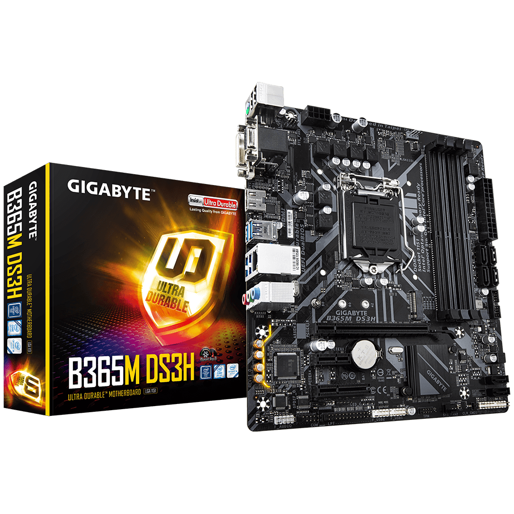

  Type: Desktop Mobo: Gigabyte model: B365M DS3H v: x.x
    serial: <superuser required> UEFI: American Megatrends v: F5
    date: 08/13/2019
