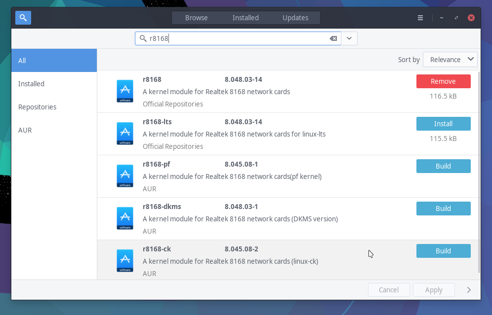

So i decided to try the BTRFSonLUKS using snapshots and hibernation and swap. When i fisrt installed and tried hibernation and or suspend the network would not reconnect. So i uninstalled r8168 and rebooted because it’s my understanding that r8169 is already in the setup. It automatically worked.
So now i just reinstalled the r8168.
Screenshot_2020-08-01_11-39-53
I rebooted the computer and it works. When i went into suspend mode and came back out it wouldn’t connect.

I had the same issue i had to remove r8168 for my Ethernet to start working again, what’s the difference between r8168 and r8169?
Welcome! There are a small amount of older Ethernet chips that need it. Most are covered by r1869. R1868 has been known to cause issues on some systems.
Technical detail is that r8168 is an out-of-tree module (so needs to be installed separately) and r8169 is an in-tree module (so is always available).
