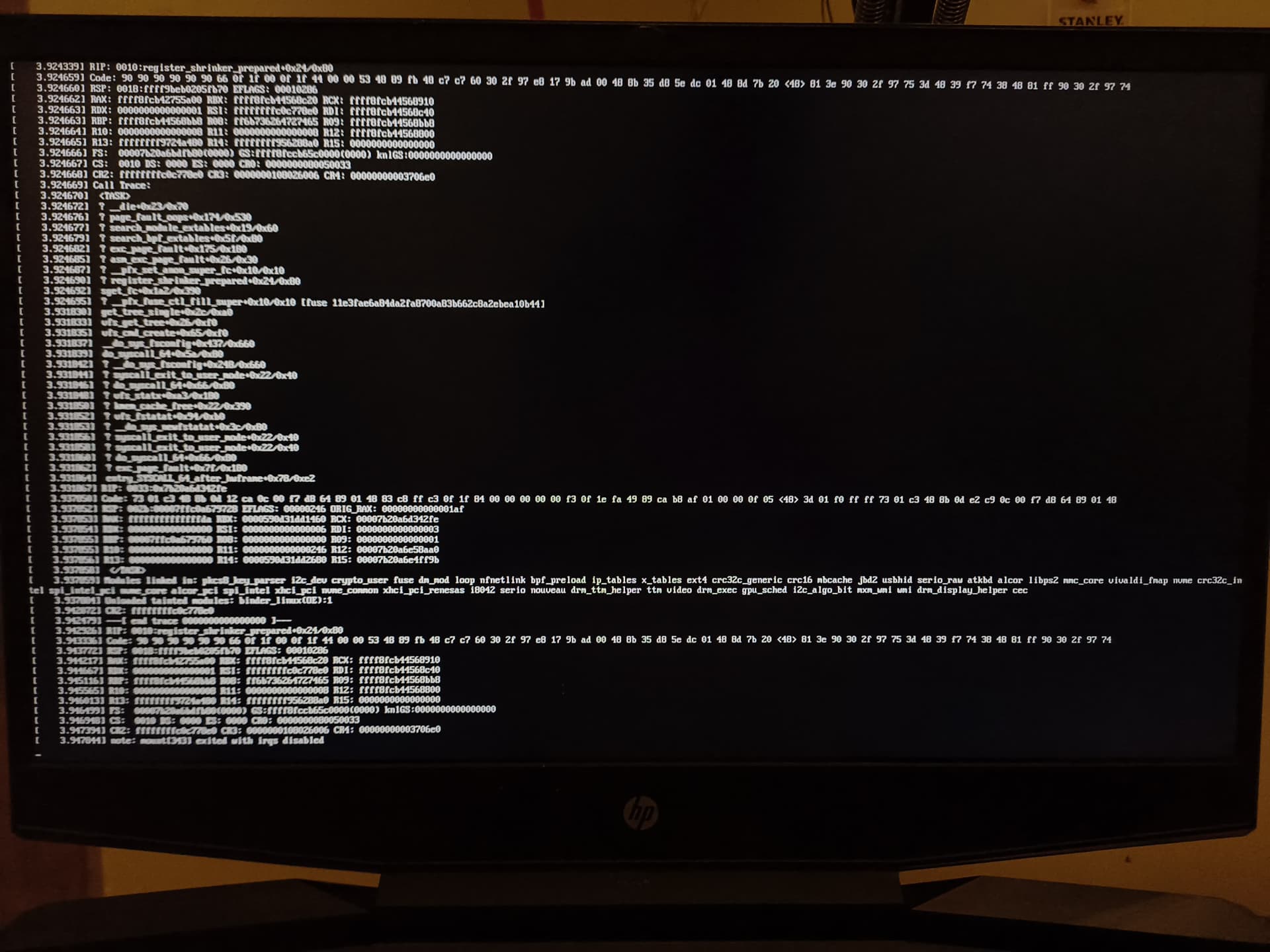

The last update messed everything up. I am unable to use the Linux LTS kernel due to this on the boot screen:
sudo dmesg | grep taint
[    3.563770] binder_linux: loading out-of-tree module taints kernel.
[    3.563774] binder_linux: module verification failed: signature and/or required key missing - tainting kernel
Currently on the Linux-linux (Base-d I think?) kernel and after 15-20 minutes it randomly freezes with a blinking capslock led until I have to do a hardware shutdown.

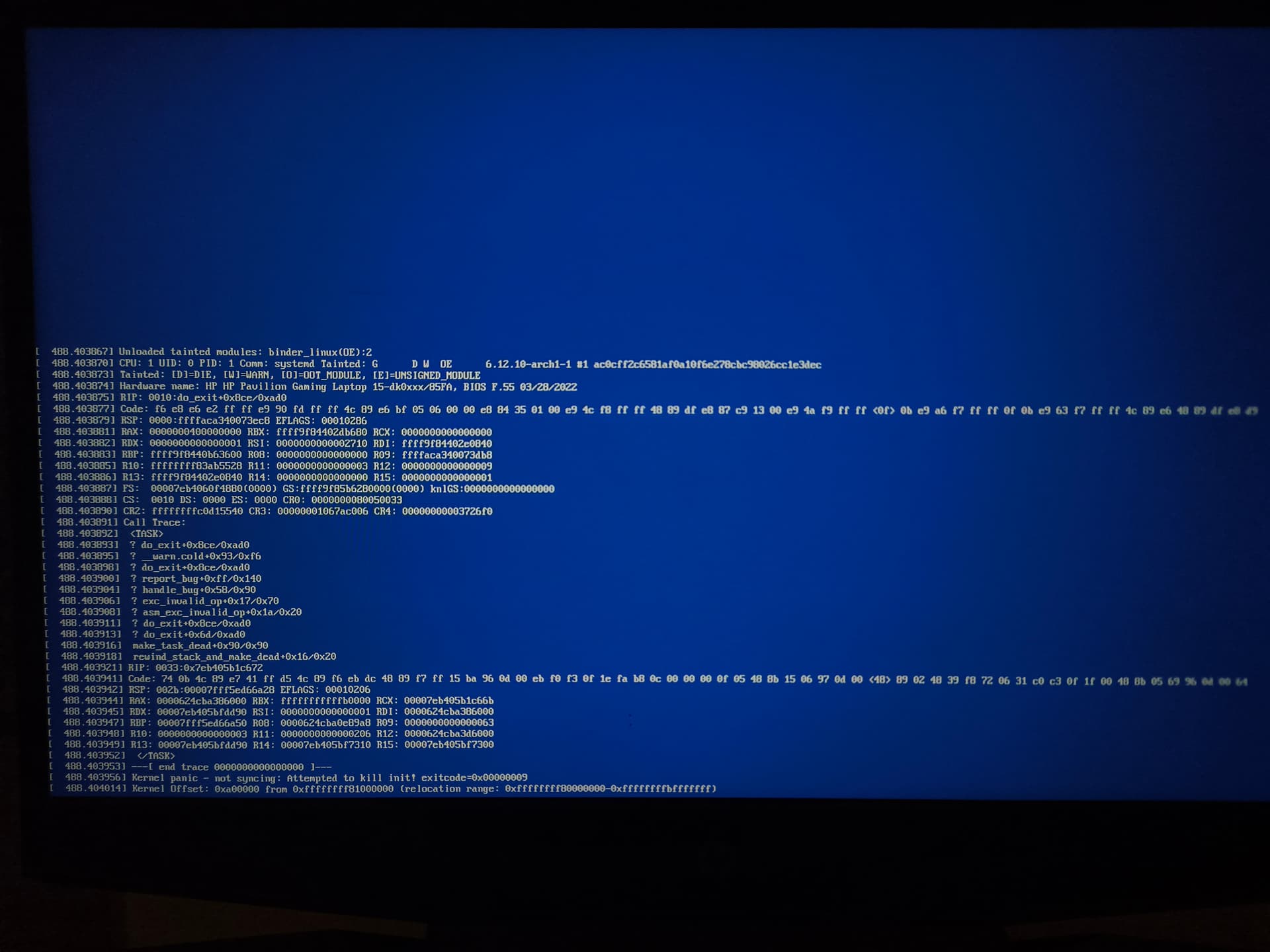

There is seriously something wrong with my system. For now I was able to boot to the linux-linux kernel for a few minutes trying to resolve the issue but now this blue screen randomly popped up. I remove everything nvidia from the kernel parameters hoping it would fix it but it didnt.
Help me out here im going caca loco.
Ok so blacklisting the “binder_linux” module in /etc/modprobe.d/blacklist-binder.conf kind of did the trick.
Now I can login to the linux-lts kernel without any hitches but the GUI is acting weird, feels like its switching over to the fallback drivers.
Seems like the system is not detecting any drivers?

Seems like the root cause of all the issues was the binder_linux module, I remember installing waydroid and it was probably someho in conflict with the nvidia drivers after the proprietory drivers received an update.
