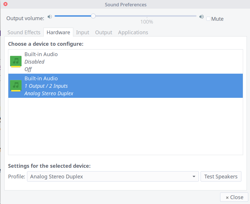

System detects two "Built-in Audio", defaults to dummy one
As per the title, rebooting my system after a few days of uptime, I found myself with two “Built-in Audio” instead of the only one included in my laptop (integrated audio card)

Worst is, my system would default to the non-working sort-of-dummy one (top one in the picture)
By turning it off, I manage to get default audio redirected to the “real” output
This way I would be able to use normally my laptop, if it were not that the Volume Up and Volume Down keys and applet do not affect the audio output through the real sound card.
I took the chance to switch from pulseaudio to pipewire in the process, but the situation is exactly the same with both.
Is there a way to remove this dummy card, or to re-associate the MATE audio widget to the correct one?

Unfortunately it seems to be the same, unless I missed any option
Here to I can turn off that secondary dummy card, but not get rid of it

The dummy card is still listed, but at this point it seems completely innocuous.
Did you re-enable the output of the dummy card?
No, I left it disabled
Try enabling it for a minute and reboot.
If I re-enable the dummy built-in stereo, the Volume up and down gets again associated to it rather than to the real built-in stereo
(in the picture, I am playing some audio as shown in the upper volume visualiser)
