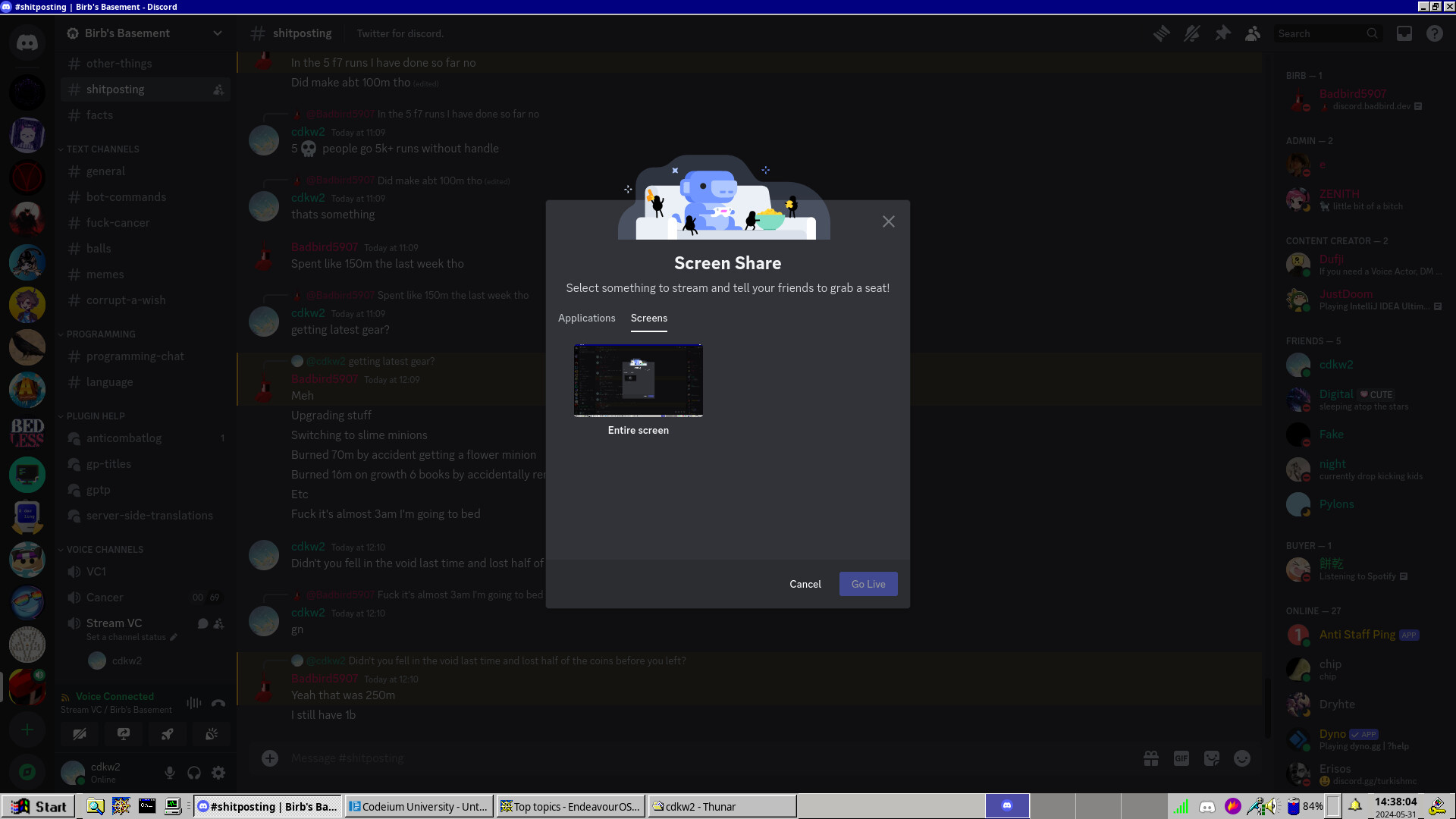

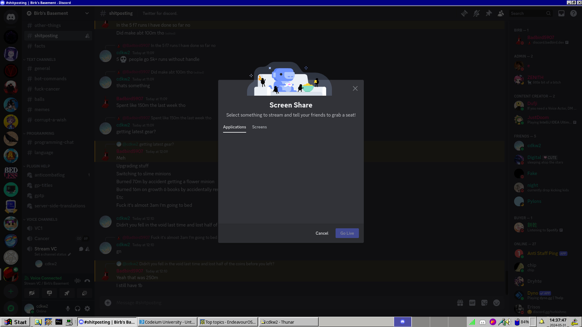

After enough of me hitting my head against the wall I have decided to switch to x11 from wayland. This apparently fixes my issue of discord and obs not not recognizing other applications for screen share as I have seen in other forum threads. Can somebody please tell me how can I switch to x11 from wayland? Do I need to reinstall endeavour os or is the change just some clicks away in soem config file? I am running xfce on a Ideapad i3-12th gen with integrated intel graphics. Any help would be appreciated. Thank you.

but I remember that on my last post about screen sharing everyone told me that the reason is that I am using wayland
Please show the outcome of
echo $XDG_SESSION_TYPE
Oh I get it now. But do you have any fix for screen sharing then? I am confused now
Can you help me with screen sharing problem then?
