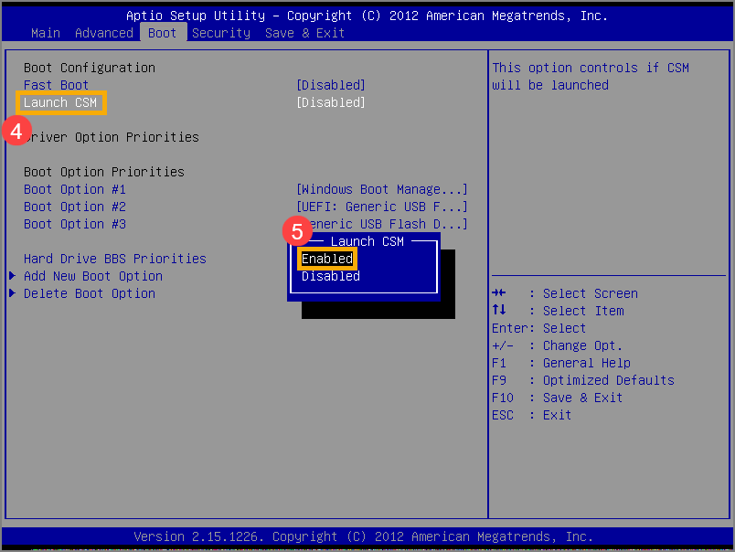

A side from disable secure boot you need to disable legacy boot options also for USB boot called CSM in most cases in the Bios Firmware interface.

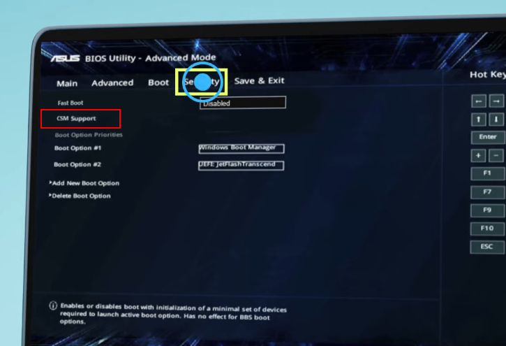

I assume there isn’t “CSM” to begin with because the option doesn’t show up where it should according to Asus.

Mine is in Legacy view and looks like this without the line about CSM. Asus also says if it “… does not have one of the settings below, please skip it and continue with the following steps”.
