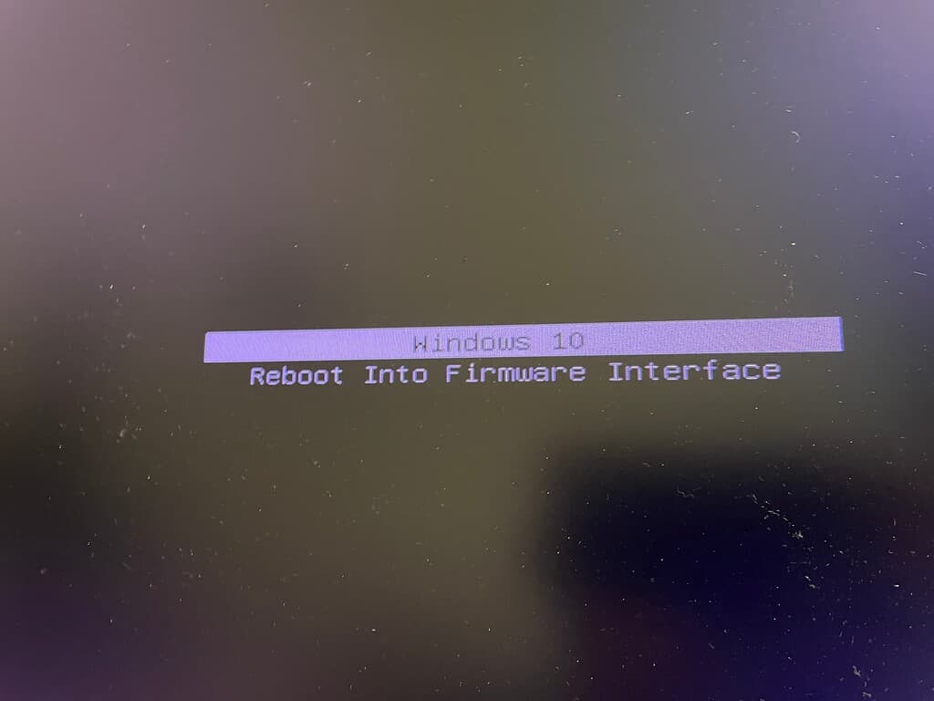

Wait. Can you share a photo of what you are seeing?
Danz
January 5, 2024, 10:12pm
11
From the systemd-boot? or bios
dalto
January 5, 2024, 10:13pm
12
I want to see the screen you see at boot with the choices.
Danz
January 5, 2024, 10:14pm
13
It’s the screen from somoene else. instead of windows 10 there is 11 everything else is the same
dalto
January 5, 2024, 10:27pm
15
Yes. That looks like an issue with something being missing.
You need to boot off the ISO, arch-chroot in using these instructions . Be sure to mount your EFI partition before chrooting!
