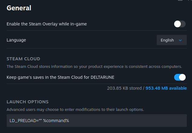

Did you add the command LD_PRELOAD=“” %command%
And is steam overlay enabled? If yes try to disable it.
Steam Overlay is disabled, And yes i did add the command to the launch arguments:

So for example if i try run deltarune:
and heres the terminal output for when i run it:
