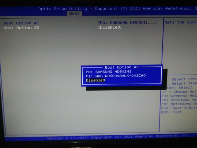

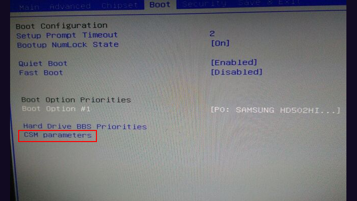

i had to format the usb flash drive again, i am providing the logs in a bit, just was a bit busy here, i took some photos from bios
just take a look at “Hard Drive BBS Prioities” thats the entry you must change it
i tried that, i can change the WD as first boot option and samsung as second, what it does is to skip to the samsung hd
The recommendation is to disable all CSM legacy boot options… but in case windows is installed in legacy mode you can not do that, as with it you will ot be able to boot windows anymore… only if you go to reinstall with efi-boot-mode enabled.
Change your first boot device to your WD driver. Your EFI config is trying to load the Samsung driver and you have your 2nd boot option disabled.
Make WD your 1st option and try. Should work.
